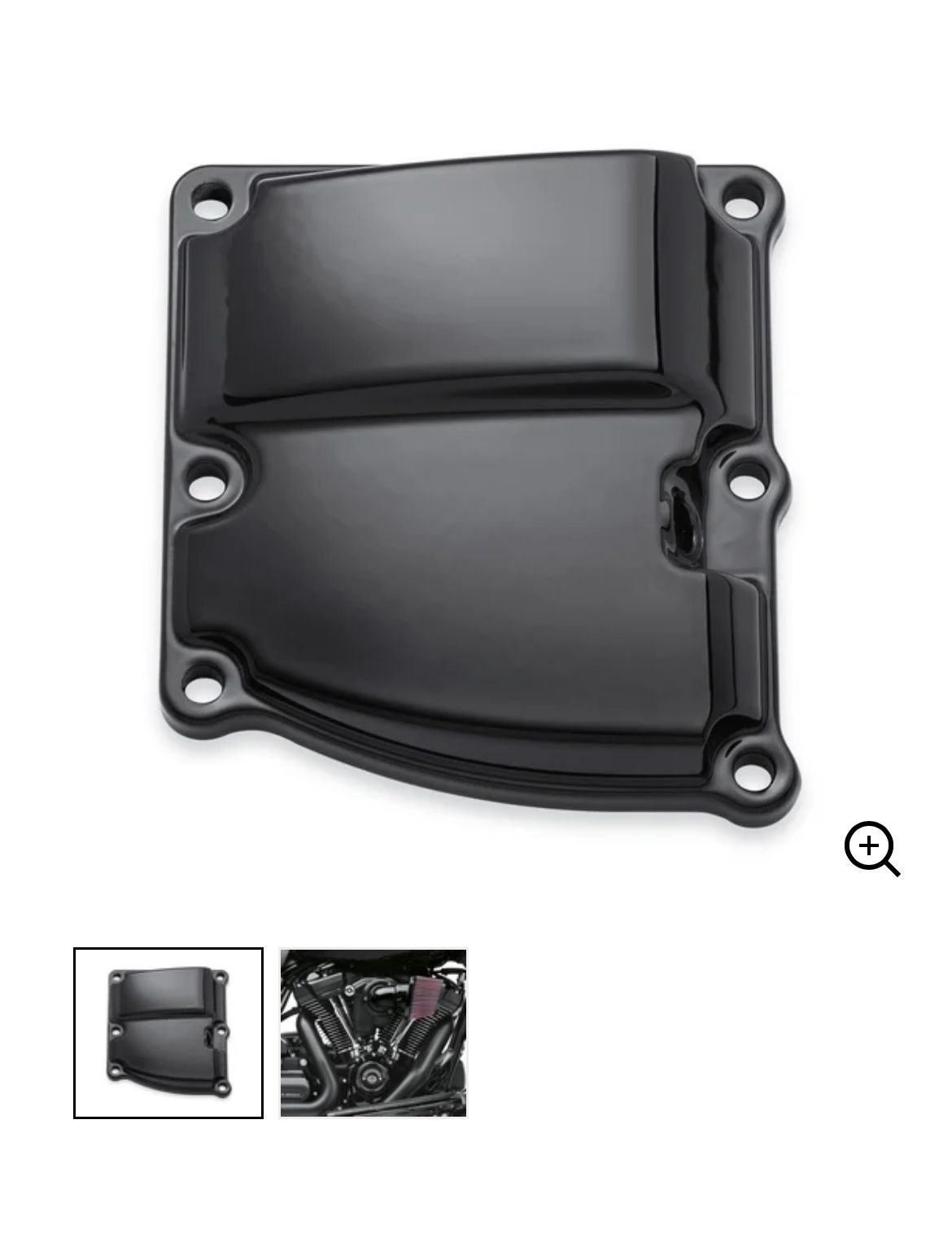

2022 RK Special here. I plan to vent my trans cover similar way Trask does theirs. There are 2 bolts that are so close to cylinder base and I dont know which tool to use. It will probably be small ratchet but any tips would help.

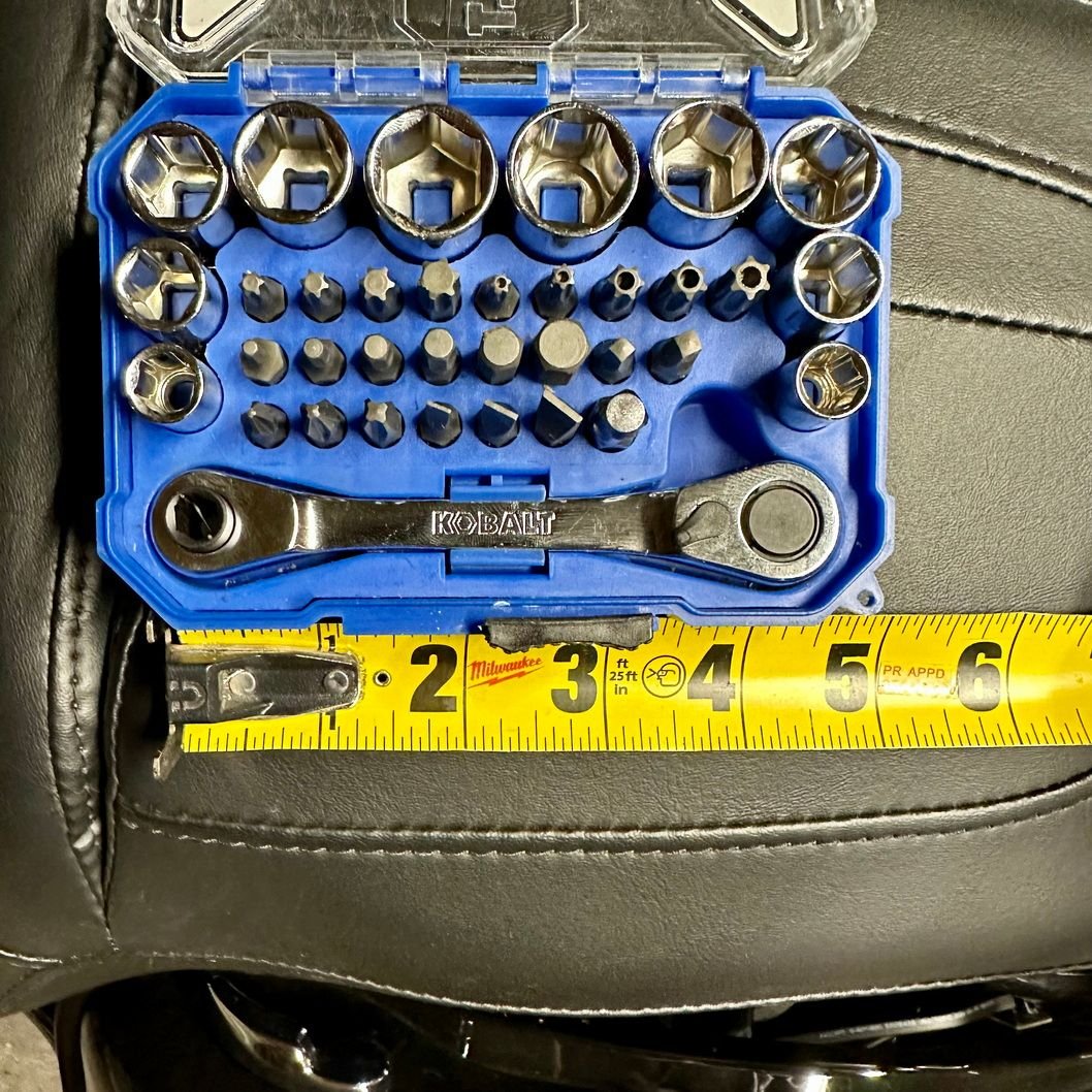

I bought this to do the same job and it worked perfectly.

any chance you can please let me know how long is your ratchet in this kit?

ANY ratcheting offset bit driver works for task. You are just putting the hex bit on the head of the bolt, and using a 1/4" bit ratchet to turn it.
Sure thing: The ratchet itself is just over 4 1/4" long (the attached iphone picture is distorted)

I did mine a couple weeks ago, mostly used allen wrenches or a 1/4" ratchet and socket, and on the 2 that are a pain because of the rear cylinder I was able to use the right size bit for a screwdriver and a small ratchet wrench that fit the bit, to turn the bit with... same idea as what Gary posted above, as long as the ratcheting box-end isn't too thick to fit in there. Really it just took patience because its tight getting to some of the bolts and you're not going to get much of a turn, and the bit wants to fall out... but it's very doable, slow and steady.
