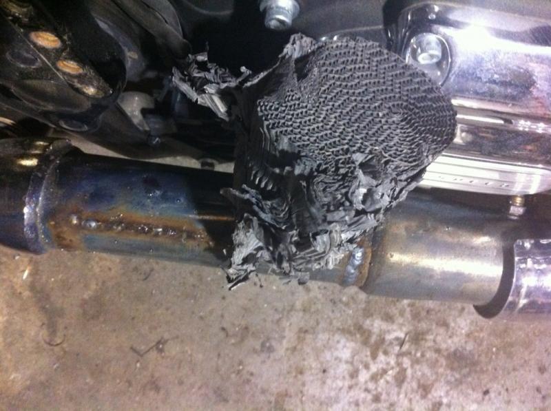

It depends on the year. Older cats may have been harder to get to than the newer ones. I cut / welded the one on my '12, but installed aftermarket headers on the '08 and '14.

I drilled out the cat on my 2014 FXDL, has a smaller outlet but still only took an hour to do the job.

There is a video on YouTube where a guy with CVO RG didn’t cut anything. He bought a long *** drill bit and went in through the back after he removed the slip on. Then he vacuumed it out.
Looked very easy. Maybe easier than cutting it open and welding it back.

Yes it will void your warranty. Do not drill out the Cat, that's a waste of time. Cut it out properly or don't mess with it.

Cut a window and knocked the whole brick out of my ‘13. About to do the same to my ‘15. The cat design is not worth a damn as a cat or anything else. Just better for everyone involved if it’s gone.

I removed mine and welded up the window. I would put a tuner on it for sure. My fp3 let me select a decatted header in their parameters on my 2018 sgs.
