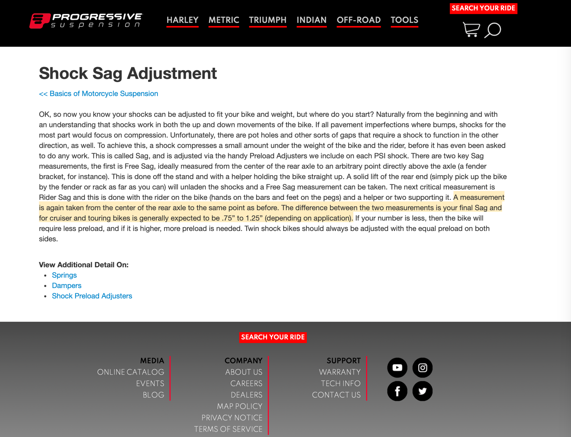

Progressive recommends 1” of sag from full extension. Measurement 1 should come with the bike on a jack with both wheels off the ground , next you need to adjust to get 1” of sag with you solo on the bike and then get your adjustment to get 1” with you two up

Set it to 1/3rd total shock travel. That's loaded weight meaning both you and the bride on it. Put a tie wrap around the shock shaft to measure with.

Once the sag is set for you, you adjust the preload for you and your better half on the bike. The sag should stay the same.
