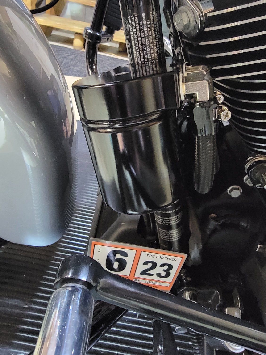

I have a 2009 Ultra Classic FLHTCU. I would like to ask you a question about the Oil Filter Relocation Kit.
Regarding the oil lines goin from the OEM oil filter mount to the new location of the DK filter mount, how much oil do they contain and do they drain out when the oil filter is removed? Also, once the oil filter is replaced how long is the engine starved of oil while the oil lines are priming to get the oil back to the engine?
I do like the idea of the this relocation kit just need to know more about it before I commit to it. Are there any pros and cons to it?.

Mongo I have two of their oil filter relocation kits and love them. There are no issues running these components and I opted for the front frame down tube mounts. I didn't care for the kits that route back to the passenger peg/floorboard.

I can't give you a number, because I don't know the volumetric flow of the pump, and I don't know if the lines drain or not. But, you've likely replaced oil filters in other vehicles, and have seen how long it takes to fill up the filter and get oil pressure up. Even with a big filter, it's just a few seconds. So off hand, I don't think you've any real worries.

The oil goes from the oil tank to the oil pump before it goes to the oil filter or the relocated filter. There will be no loss of oil to any componets. At least this is how I read the oil circulation diagram. If I am mistaken someone chime in.
