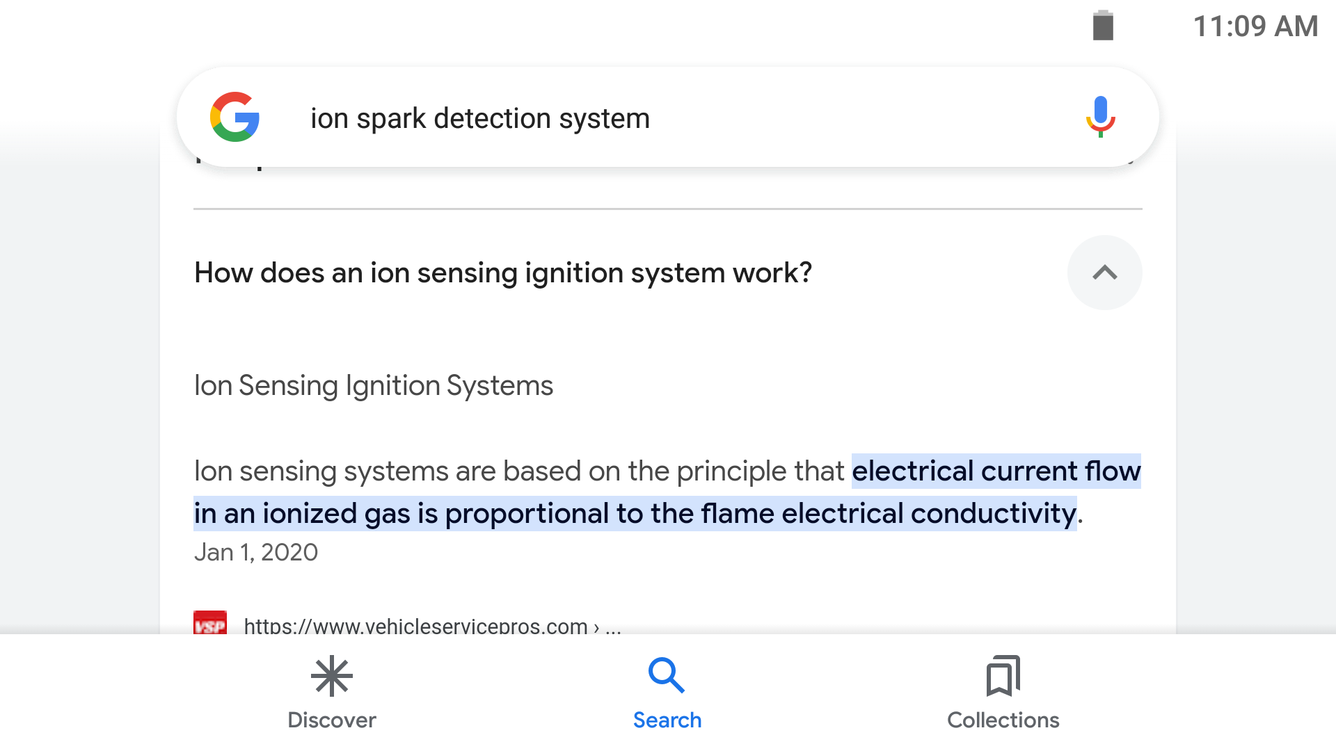

Originally Posted by Jackie Paper
Put a set of the Harley branded plugs in it. Yes, Harley doesn't make them but there low resistance plugs special for your ion spark detection system that the coil reads and relays to the ECM .
Glad you got it fixed but you need to protect it on hills, hard throttle or getting more gear then motor likes .
If you get them, check the resistance and compare them to what you put in and report back to us as a favor for all the hard work we do on here
I do get paid 24/7 but I need better note .
I recognize all of the words but have no idea what that means. Ion sensing must be magic. "Flame electrical conductivity"? Must be in microvolts or megohms.
