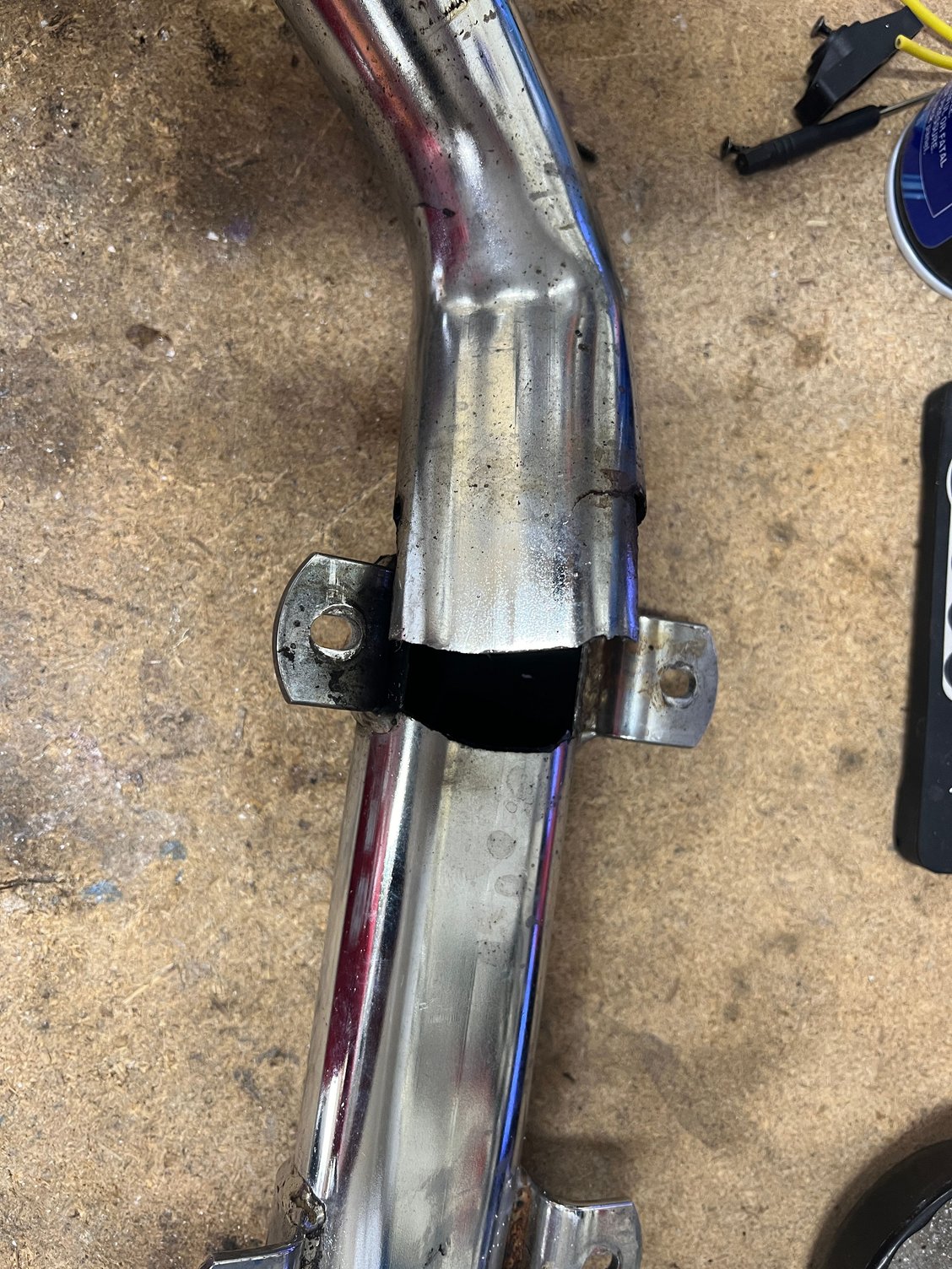

Pulled the broken part off the bike this morning.
Looks like there are some ‘stress cracks’ around where the factory S&S welds…and from carbon build-up, it sorta looks like it may have been cracking/weakening for a while.

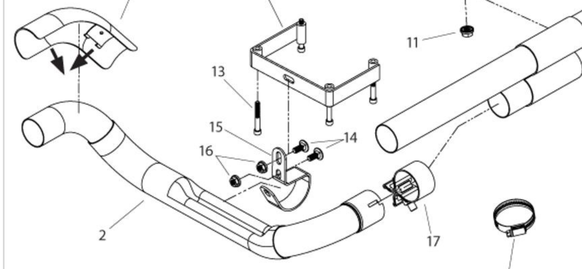

The complication with that is, according to S&S’ website there was a revision to this Header system that changed the mounting method for that crossover pipe. The revised method seems better, as it doesn’t involve the ‘straps’ (see above photos) that are welded to to pipe - instead, it uses a ‘clamp’…along with a different bracket to hold the clamp. This will require me to buy the clamp & bracket and immediately modifying it so it will fit with my Frame Stabilizer.

IIRC, that OEM crossover pipe on both my 2012 bagger and 2016 bagger had slip-on clamp securing that crossover pipe.
I have seen a few aftermarket headers that use brackets/mounts welded to the head pipe, eventually develop cracks at the weld between the bracket/mount and head pipe.
It seems that S&S has made a change to a slip-on bracket, like another popular vendor made to one of their head pipes that had a welded mount until cracks started to develop.
I had the same issue with an exhaust I bought, and the vendor immediately sent me a new head pipe with the new clamp system.
It would seem that a welded bracket clamp/mount, on a rubber mounted engine exhaust header, isn't the best design for an exhaust clamp in that application.

Yep. That’s kinda what I was thinking.
Newer design seems to allow for a bit of movement/flex.

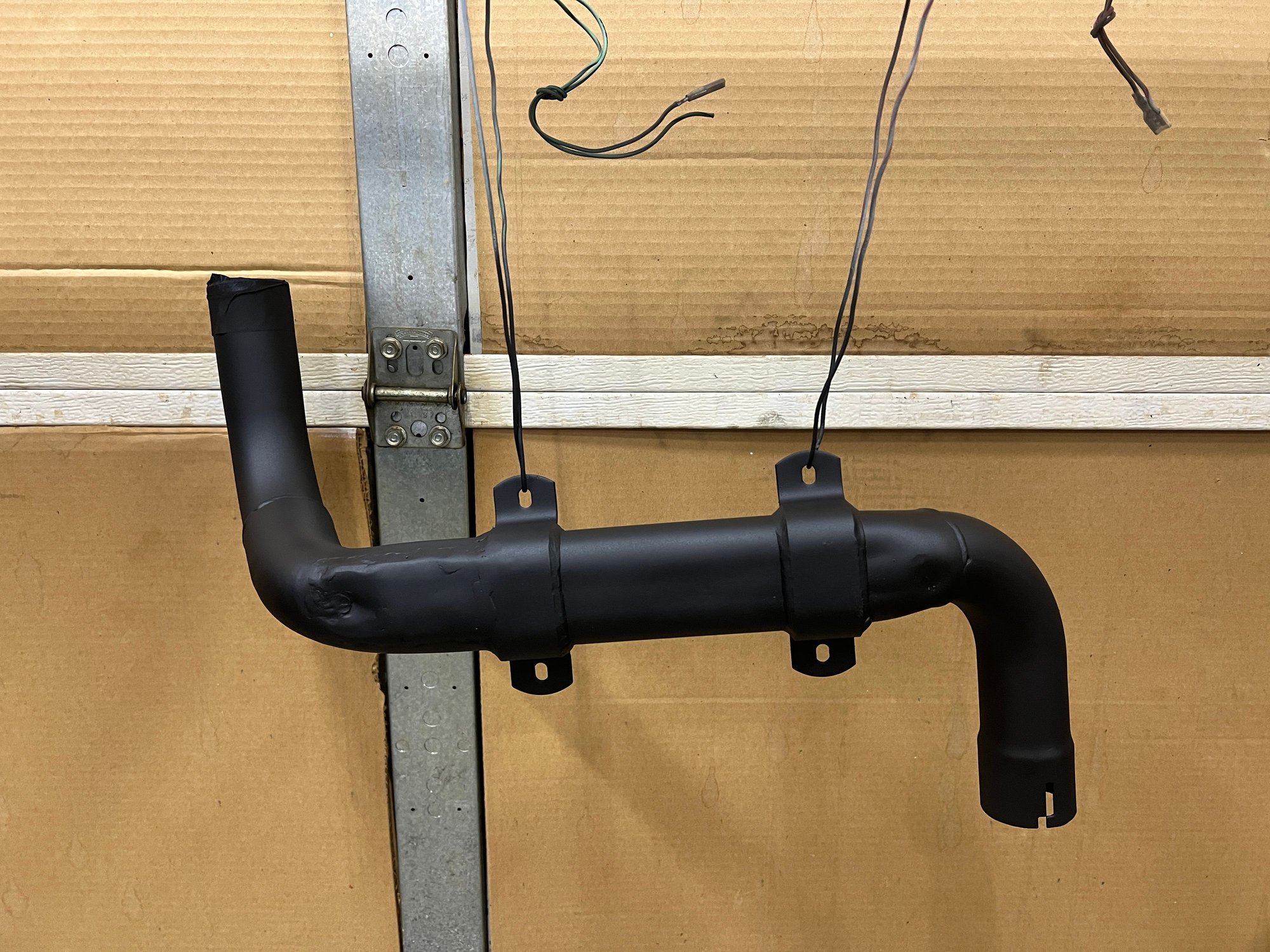

New design. Bracket to Oil Pan w/clamp around crossover pipe.
Original design. Rigid mounted crossover to bracket to Oil Pan.

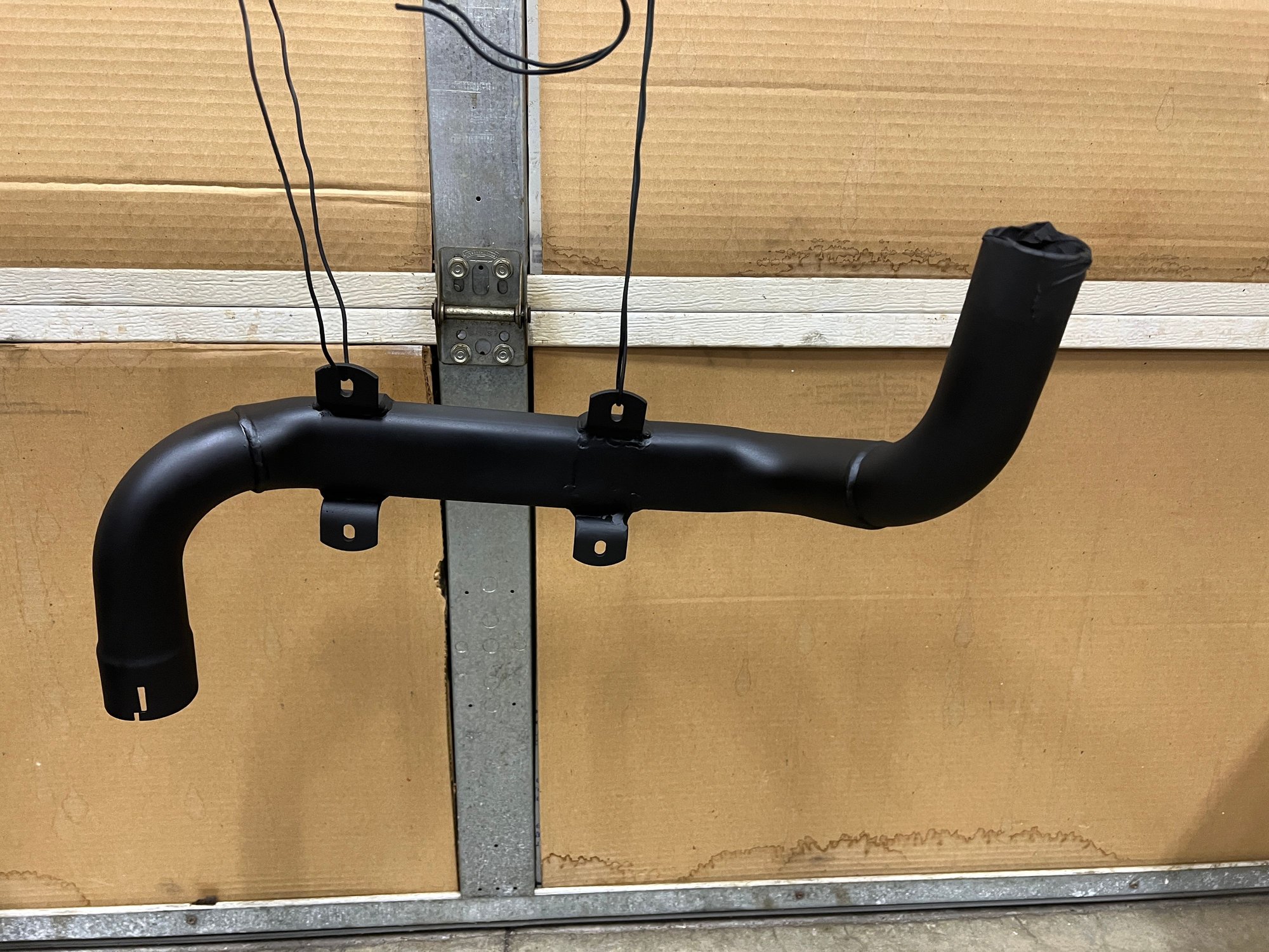

So. I had the broken pipe welded & reinforced.
I had the repair done, and hit it with High Temp primer & paint.
Seems good. All went back together smoothly and properlike. I guess that’s better than having to buy new headers? 🤔
