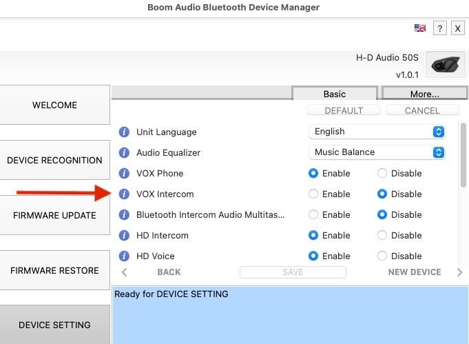

Do you have VOX intercom disabled?

I have all VOX options disabled. I've gone through and triple checked my settings. It doesn't seem to be tied to a headset because the intercom indicator will blink even if there aren't any headsets connected. It's so weird. I wonder if there's a way to re-flash the entire radio system.
