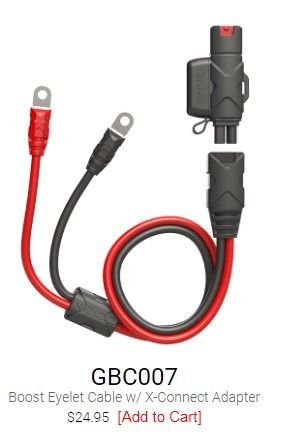

I wanted to be able to jump start my bike without needing tools to remove the ECU tray, so I bought the NOCO boost adapter cable and routed it behind the right-side side cover. It plugs directly into the output of the NOCO 1000-amb GB40 battery booster that I always carry in the saddlebag. The wire gauge on the NOCO adapter is sufficient for jump-starting, unlike the standard SAE charging adapters.
