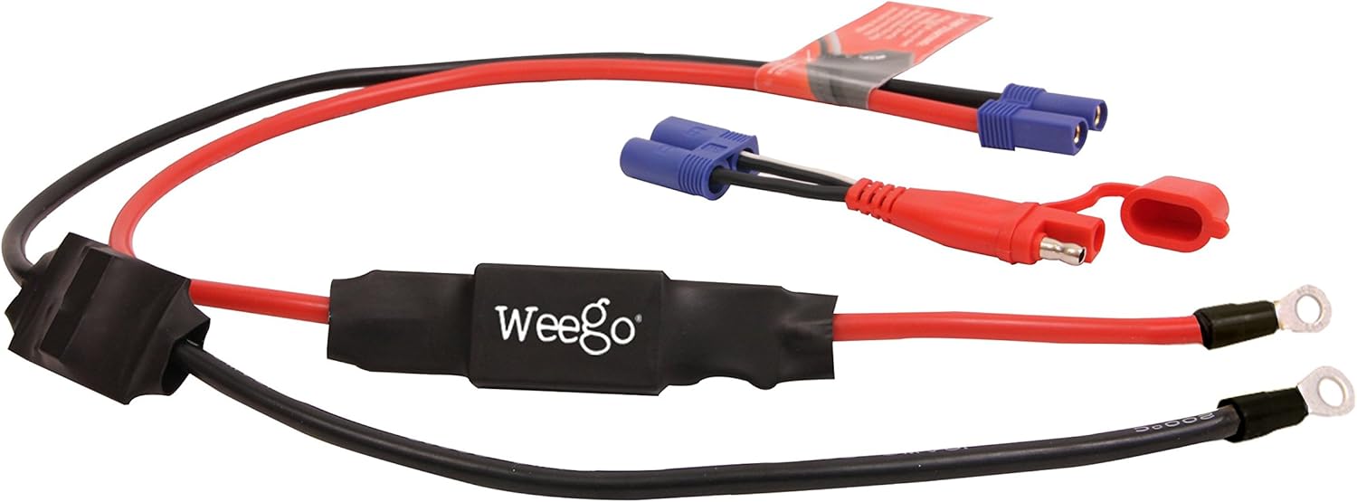

Amazon Amazon
Here you go if you don't want to build your own jumper/tender cable for the bike, and keep a charged lithium jumper with your bike in the saddle bags.
Amazon Amazon
Hence not hard to just use the starter solenoid positive terminal, and ground on the bike, but with jumper/tender cable already on the bike, make jumping the bike a piece of cake when the battery has problems.

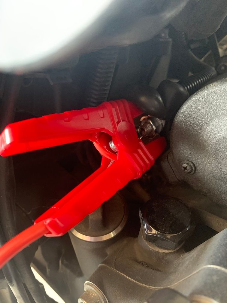

I've not seen it first hand, only read about it. Usually it will pop the fuse and at worst burn down the bikes wiring harness.
The battery to starter/frame ground cables are huge and a properly working starter can pull up to 90 Amps through them. A bike with "issues" can pull 250 Amps...
The bike's main harness is rated for 20 Amps max?
It really isn't hard to connect a jump pack (on Touring models anyway). See below.
