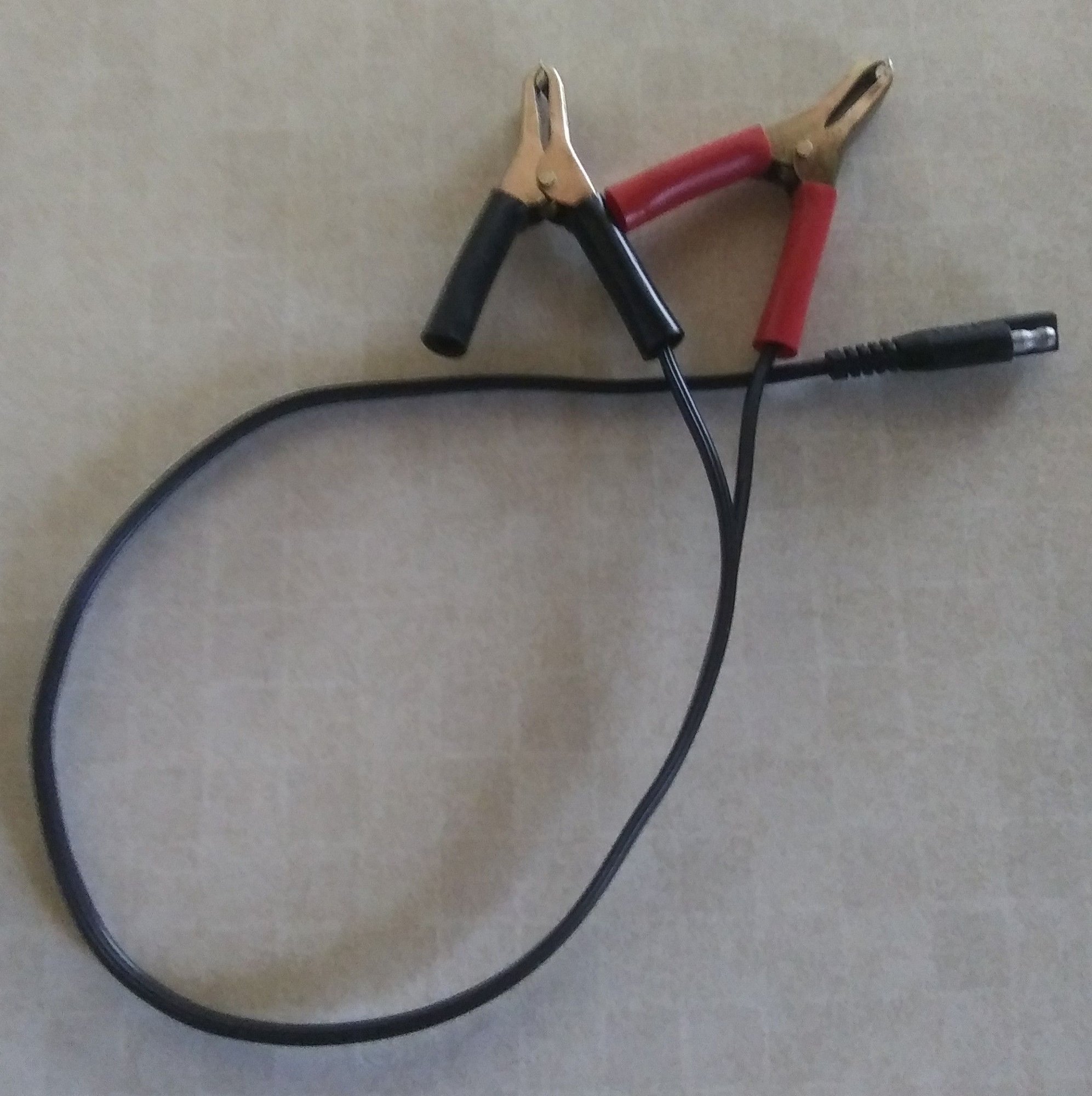

FYI. If you connect this to your factory tender connection, the black clip will be positive, and the red clip will be negative.

It is also not recommended to jump the bike through the tender harness. Would be bad to fry this harness with extreme current.
I've heard this as well.

You can make one of these to carry with you and it does not take up much space in case you need to use jumper cables etc.
Not to mention, the factory tender harness has a 5 amp fuse in it. You wont get far with that.
https://www.youtube.com/watch?v=I5Nn736TYJs
Good idea
The factory tender connector on the OP's bike is protected by the 20 amp P&A fuse.
