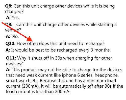

Originally Posted by 81shovelhead
Does completely draining battery once in a while trally do much for battery life?
I've heard about it for cell.phones but then heard others comment that it wasn't necessary.
cessarySo.ething about battery "memory".
Most lithium powerpaks nowadays don't have a "memory", and thus you don't have to drain it. You just need to have it "topped off" like your phone. Here's one of the FAQ on my GooLoo Jump Starter

I think the battery memory thing was back in the Nickel Cadmium days. It seems the only thing with Lithium is they don't like to be stored for long periods fully charged. Works out great for my wife's tools, she likes to discharge them regularly.
