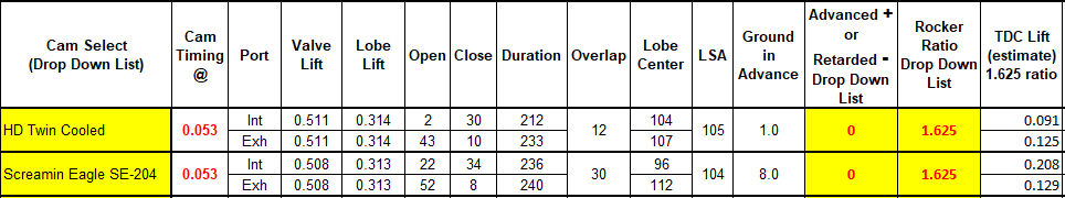

The cams should give some boost in power over what you have now. Your bike has the 103 HO cams, where as a Softail of the same year has the old OEM cams from 2007. I mean the price is right and you'll be there, so why not.
As far as the tuner, one of the tuning guys will be here to advise about that.
Below are the 103 HO cams and SE204 cams specs.
