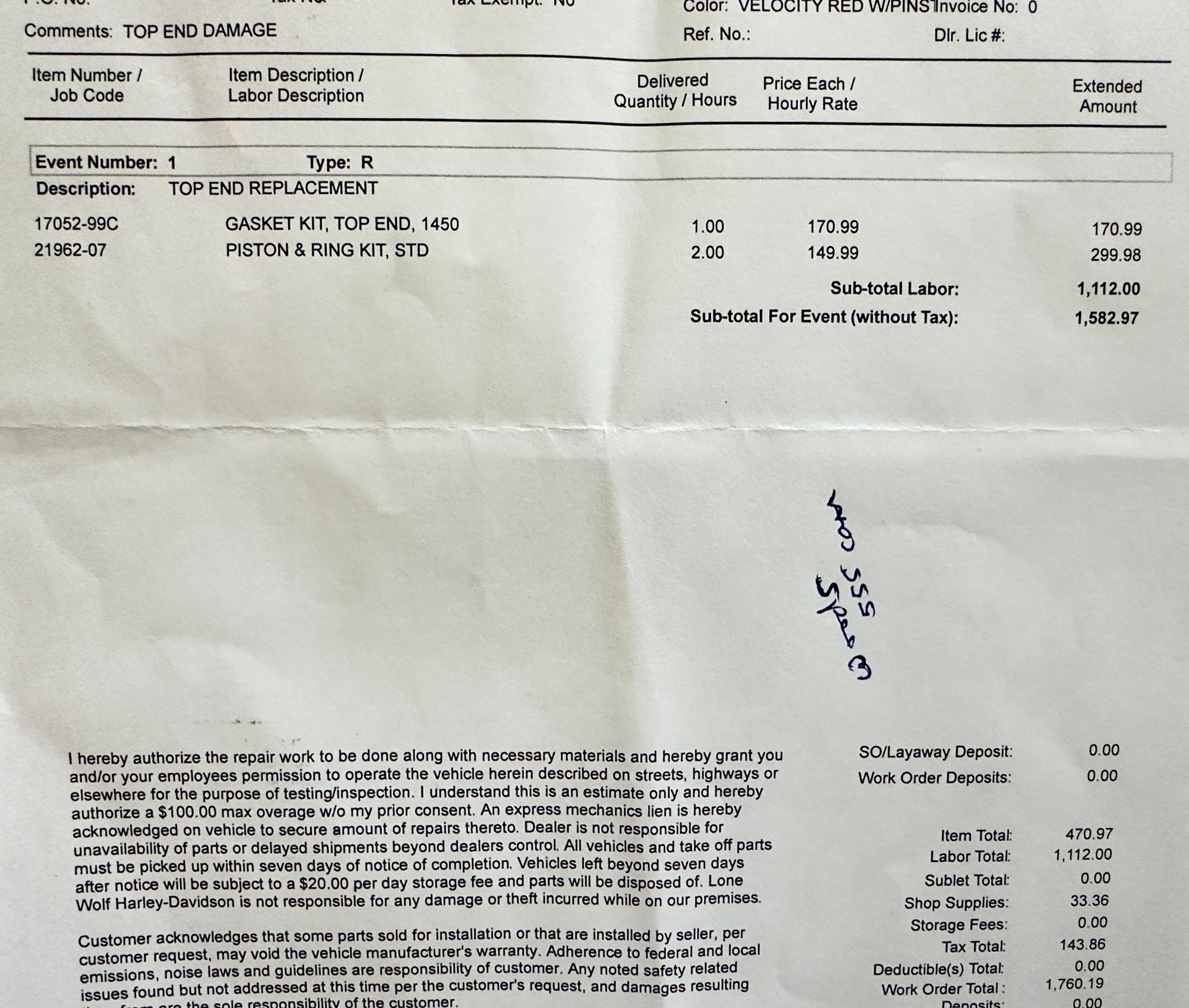

Quote I got from local dealer was for replacing both pistons and ring kit. No new cylinders.
complete gasket kit
complete gasket kit
That is a better way to go.
Looks like the gasket kit is $170.99
Yeah, it read like you replacing a cylinder ...
Given this info now I just plan to replace stock cylinder and piston from Harley.

Originally Posted by Harley_ish
Well, this is what we read ...
I had to revisit my order estimate after I put that here. I was under the impression kit included cylinders, Looks like no cylinders only pistons and ring kit. Not sure if I need new cylinders, I'm guessing once they open and look inside, they will let me know. Plus I'm bummed about this and not paying attention, looking at Fuel moto kit and other options. So my mind is all over the place. I was really hoping this bike would go past 100k+ without hiccups. But that's not the case. Have been also thinking of Can AM or something else. But then I feel I should fix this and give another shot.
Hone is very important. Do not put new pistons in old cylinders without honing.
I hope the quote you got for labour would include this.
Thanks just called Lonewolf HD and service tech told me that they will hone and do necessary work on the cylinders for new pistons. I asked him to also add replacing 2 tensioners, lifters and oil pump.
