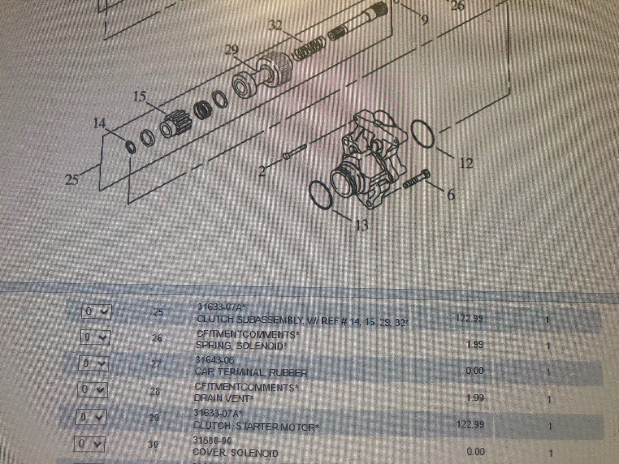

Investigate part # 29 ( disconnect battery first please )
Check your compensator nut while you have the primary cover off

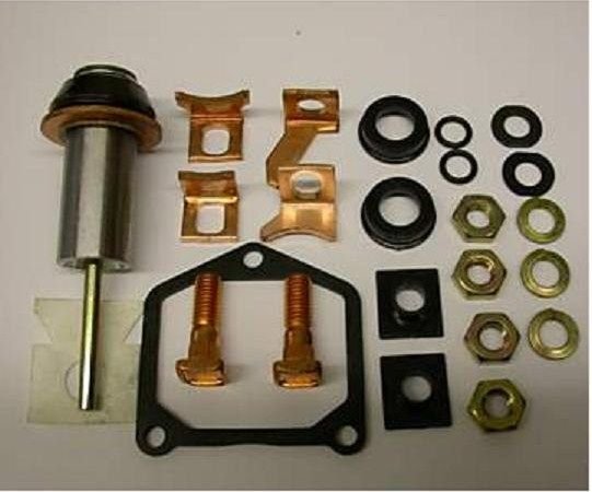

Solenoid repair kits are available for a lot less than replacing a starter. A bike that old will have some serious pitting on the contacts which will cause inconsistent contact when you press the starter button. What you may be hearing is that plunger going in and out. The solenoid repair kits include all of the contacts, the plunger and all the necessary nuts, bolts and gaskets. I'm not sure what the exact price would be for your bike, but my bike it was about $35. You do have to pull the starter out of the bike to do this. I have a Fat Boy and it also required me to remove the oil tank. If you do not have an oil tank on your bike, then removing the starter and rebuilding the solenoid should be very doable with medium mechanical skills. There are plenty of YouTube videos that go step by step.
Good luck. I hope this helps.

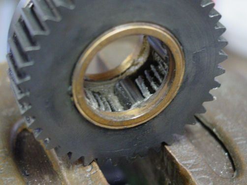

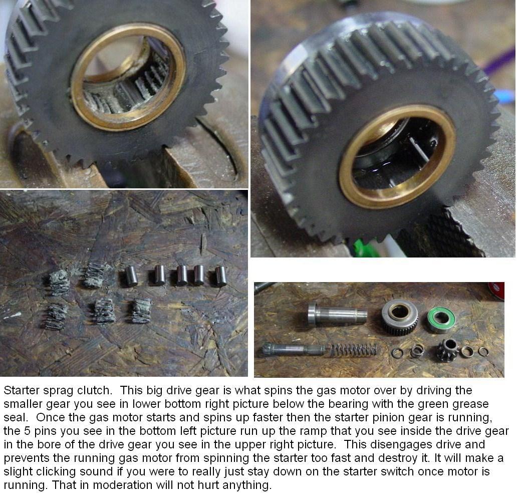

Your definitely not stock. I have seen metal on the primary magnet from new. Steel metal to steel metal on the drive fingers rubbing together to dampen the two cylinder engine to smooth impulses.
If it doesn't bang when you shift running down the road and not excessively noisy with a two ear stethoscope, I would not worry about it.
Your listening to tin men or those that did and passing it on.
That's not your starting issue. Varied load on the starter pinion is not what keeps it engaged. A 12 volt electric magnet does. And the sprag clutch on the starter gear assembly drives against stops on a ramp.
It disengages if you happened to keep on starter after motor starts. Then the gas motor out runs the electric motor and the drive roller pins run down the ramp and gear runs free of the starter motor.
Similar principle as the rear hub on a 10 speed bicycle. Bicycle just uses a paw lever. That in the starter is hardened roller pins bearings.
I know.. that's going to start the Götterdämmerung up. ..
