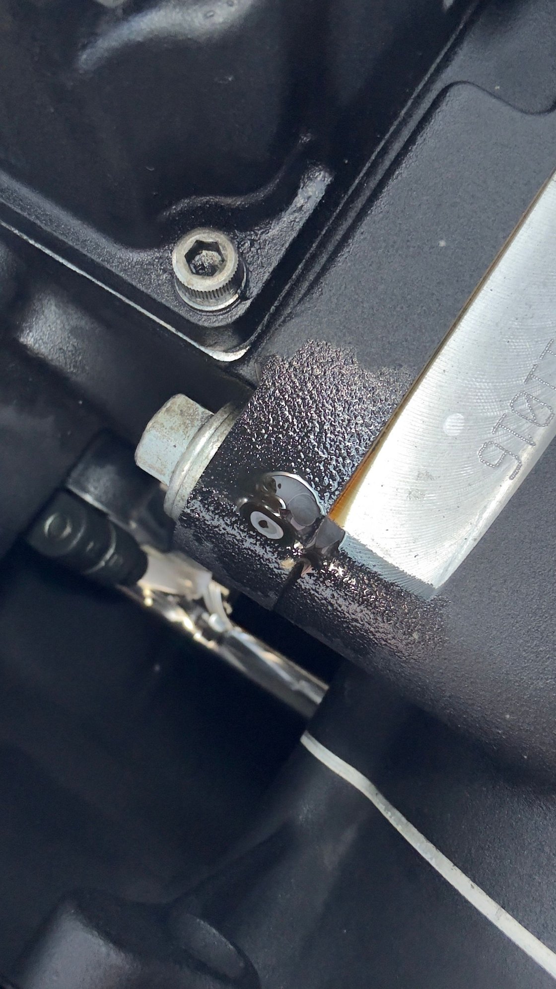

When did you smash the oil pan and put that big gouge in it?

I was just gonna ask the same thing. Make sure no oil seeping out of that gouge, especially when hot.

Not sure I would call that a big gouge, but I have no idea how that happened. I’ve never seen any oil from that area, though.

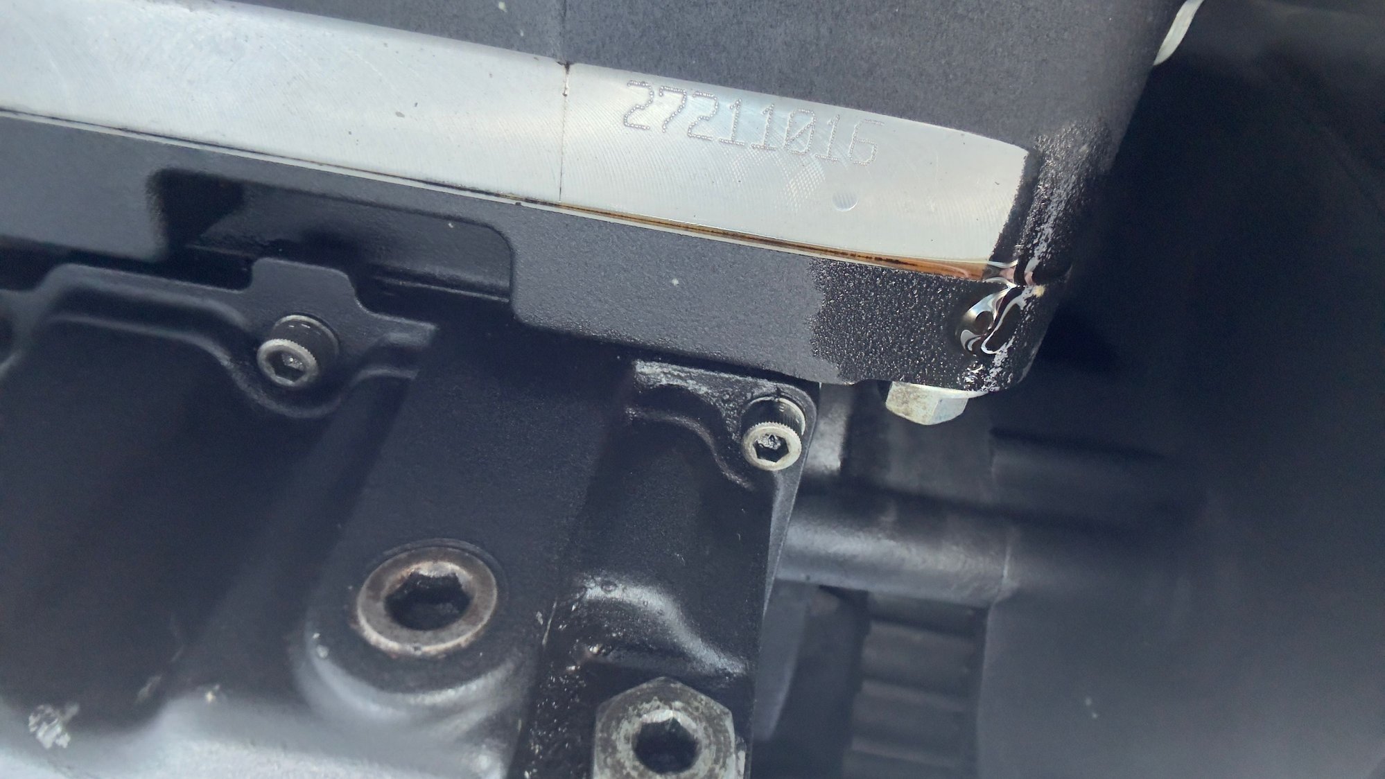

I found it. I just hope it's not too hard to repair.
Anyone have any thoughts?

Is it coming down from the other drain bolt above it?

It's difficult to tell, but I did check the bolt and it's tight.

The way the oil is seeping, it looks likes it’s coming from further up on the right side and spreading and puddling up on the bottom. What do you see further up the side?

From this picture, it doesn't seem to be leaking at the drain bolt.

I can't really see or feel anything further up.
