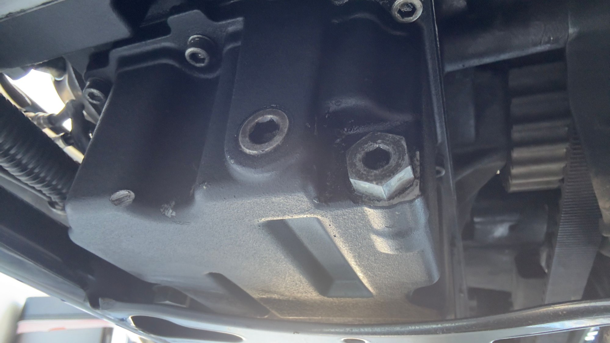

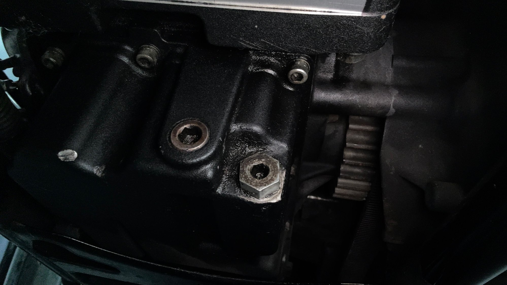

I think I found the source of my oil leak. Looks like the drain plug O ring is missing.
Not necessarily. I'm pretty sure you can't see the o-ring when it is properly seated.
Old Jan 24, 2025 | 05:24 PM
paulhog's Avatar
paulhog
Joined: Jan 2010
Posts: 527
Likes: 42
From: Sequim, WA
Darn! Then the hunt goes on. It started after my cam upgrade. It's real clean oil that's leaking. I'd bring it back to the shop where the work was done, but I've moved out of state. Thanks for your input.
Old Jan 24, 2025 | 05:41 PM
Jetblack3's Avatar
Jetblack3
Joined: Jun 2012
Posts: 439
Likes: 435
From: Iowa
Clean the whole area really well with some brake cleaner then let sit a day, maybe go for a short ride and watch closely. It should tell on itself
Old Jan 24, 2025 | 05:54 PM
oldnslow's Avatar
oldnslow
Joined: Feb 2022
Posts: 176
Likes: 244
From: IN
Just because you don't have anything else to do, See if the oil pan bolts are snug, I had a leak I could not chase down, Found few of the bolts were loose, no leak since
Old Jan 24, 2025 | 06:06 PM
Campy Roadie's Avatar
Campy Roadie
Joined: Aug 2011
Posts: 11,814
Likes: 5,120
From: SW Ohio
Check the two fasteners that hold on the exhaust bracket/hanger on the right about mid way.

Old Jan 24, 2025 | 08:49 PM
cobra23's Avatar
cobra23
Joined: Jun 2013
Posts: 1,058
Likes: 953
From: Sarasota Florida
Harley says to replace the drain plug o ring with every oil change. A lot of techs don't bother to do this.
I decided to change the oil myself after the 1000 mile service. The o ring was shredded and barely held together. That's why you pay so much for dealer service ...

Old Jan 26, 2025 | 09:08 AM
paulhog's Avatar
paulhog
Joined: Jan 2010
Posts: 527
Likes: 42
From: Sequim, WA
I couldn't find any loose bolts. Cleaned the whole area, then ran some errands with it. It's not leaking now, but I'll keep an eye on it.
