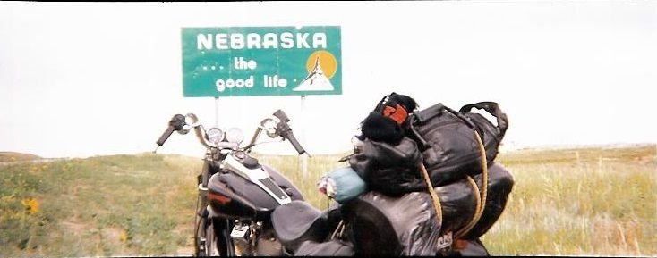

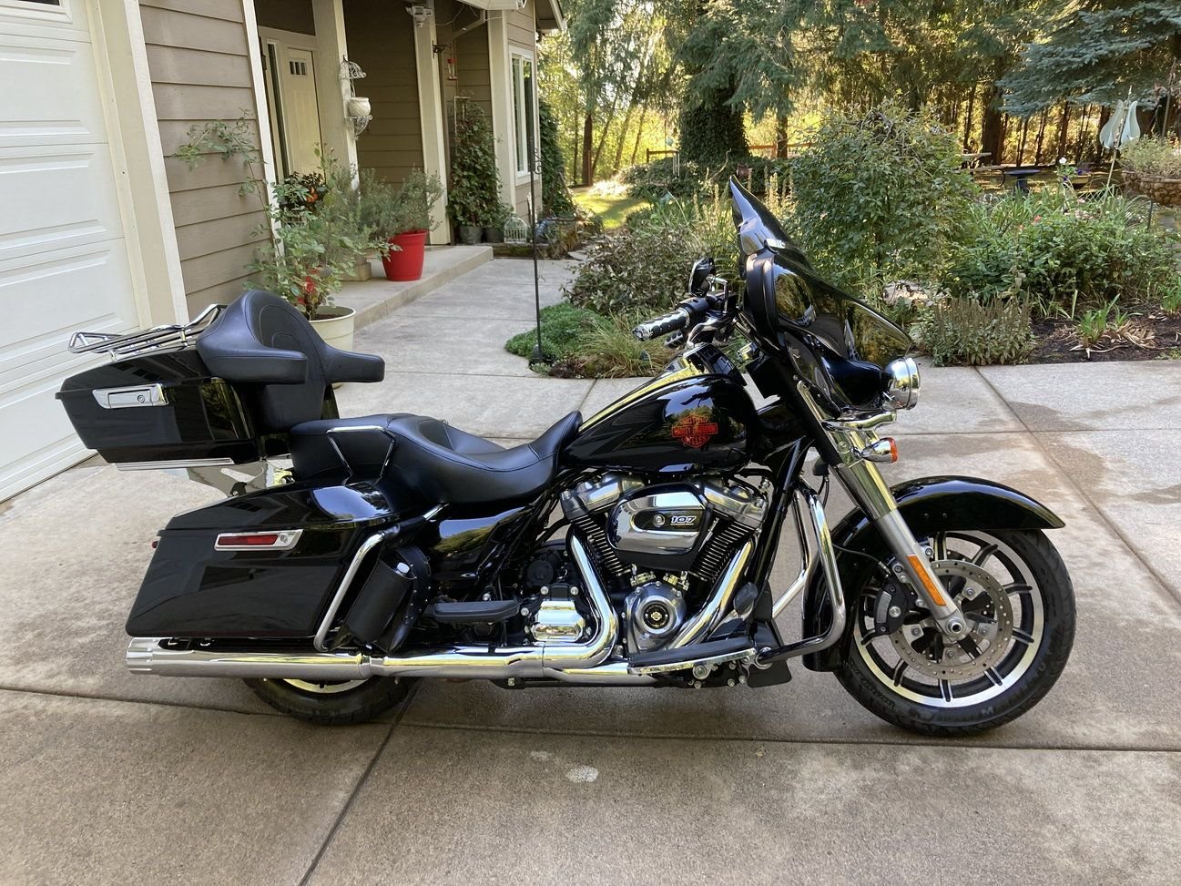

Thanks I'll look it over, I loved the bucks on my old FXRS for comfort especially the fact that the grips pointed down quite a bit.
My left elbow doesn't straighten out more than 75% from an old injury so being able to keep it bent and pointed down taking weight off it really helps a lot.
I also had 4" risers with a 2' pullback, wish I could duplicate the position of those grips on my bagger.
The bars on my 2019 FLHT pretty much suck for me, it's the only comfort mod I haven't addressed yet because I just haven't been able to find what I'm looking for.
(man that FX pic was a long time ago lol)
