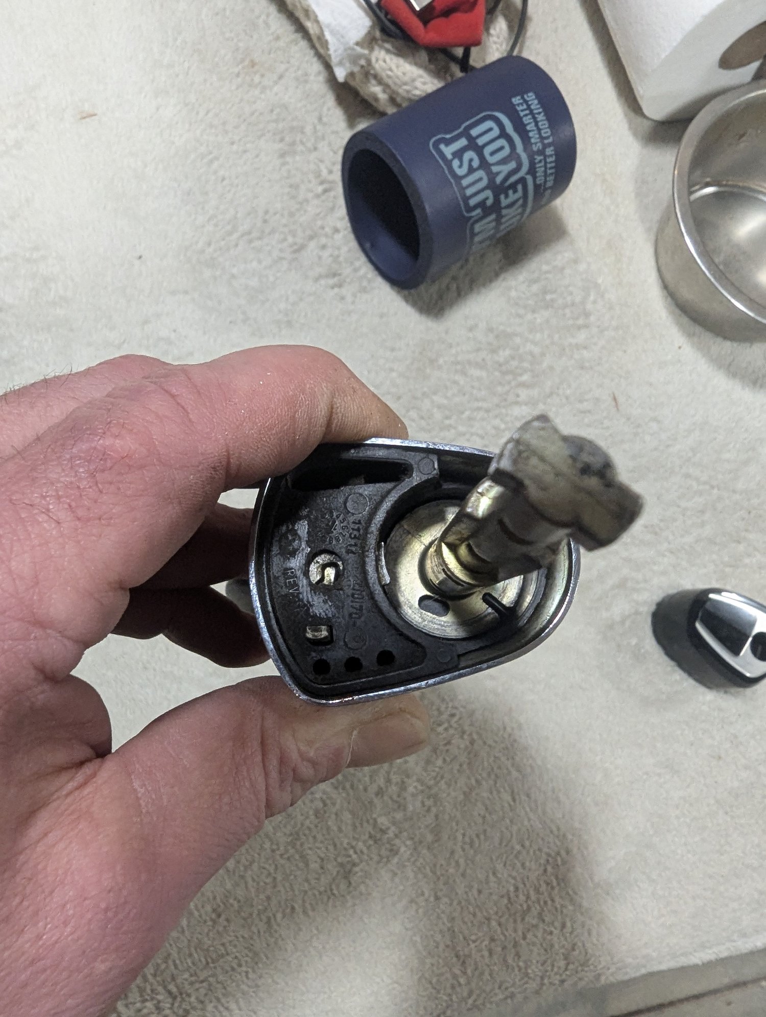

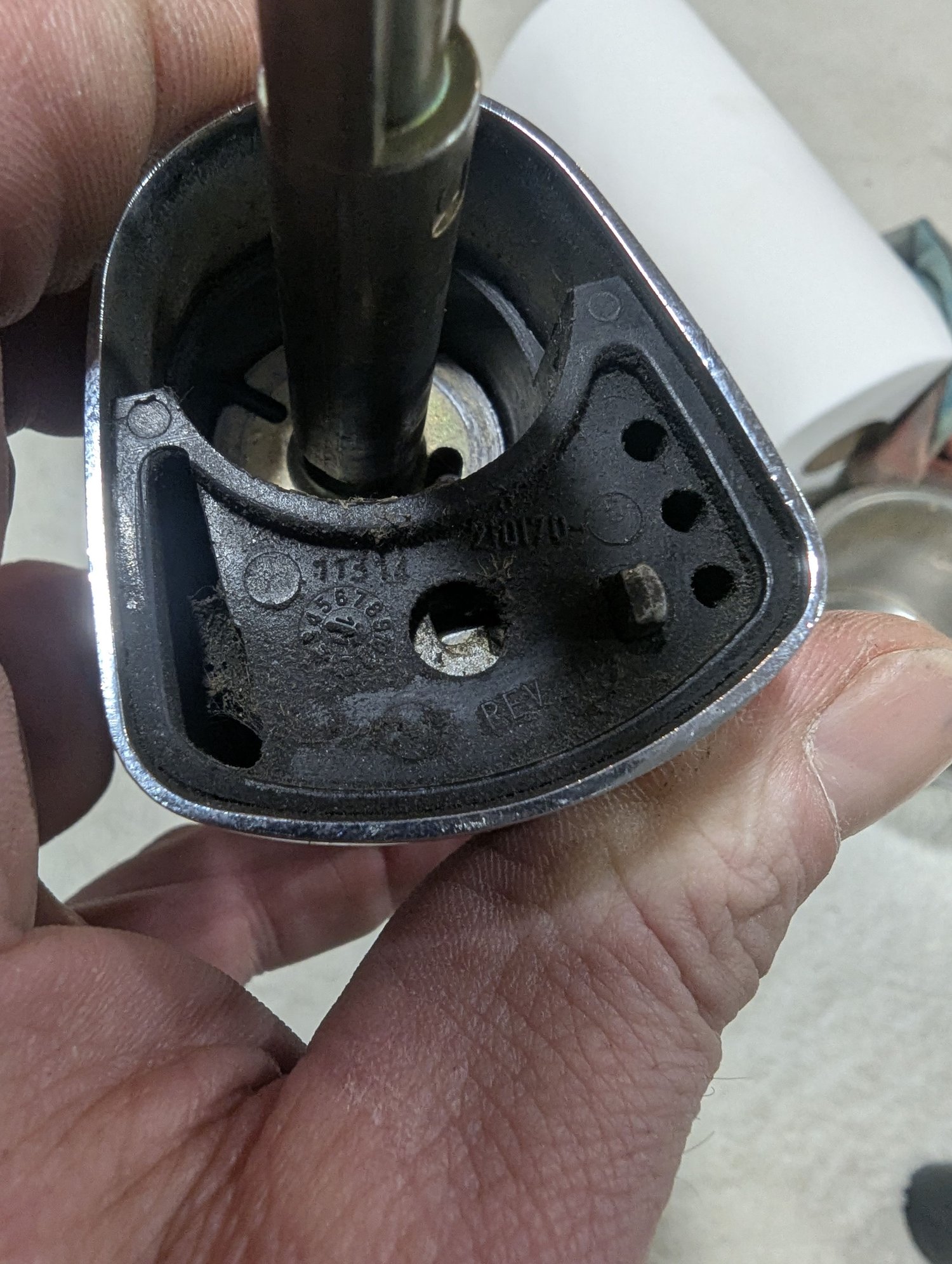

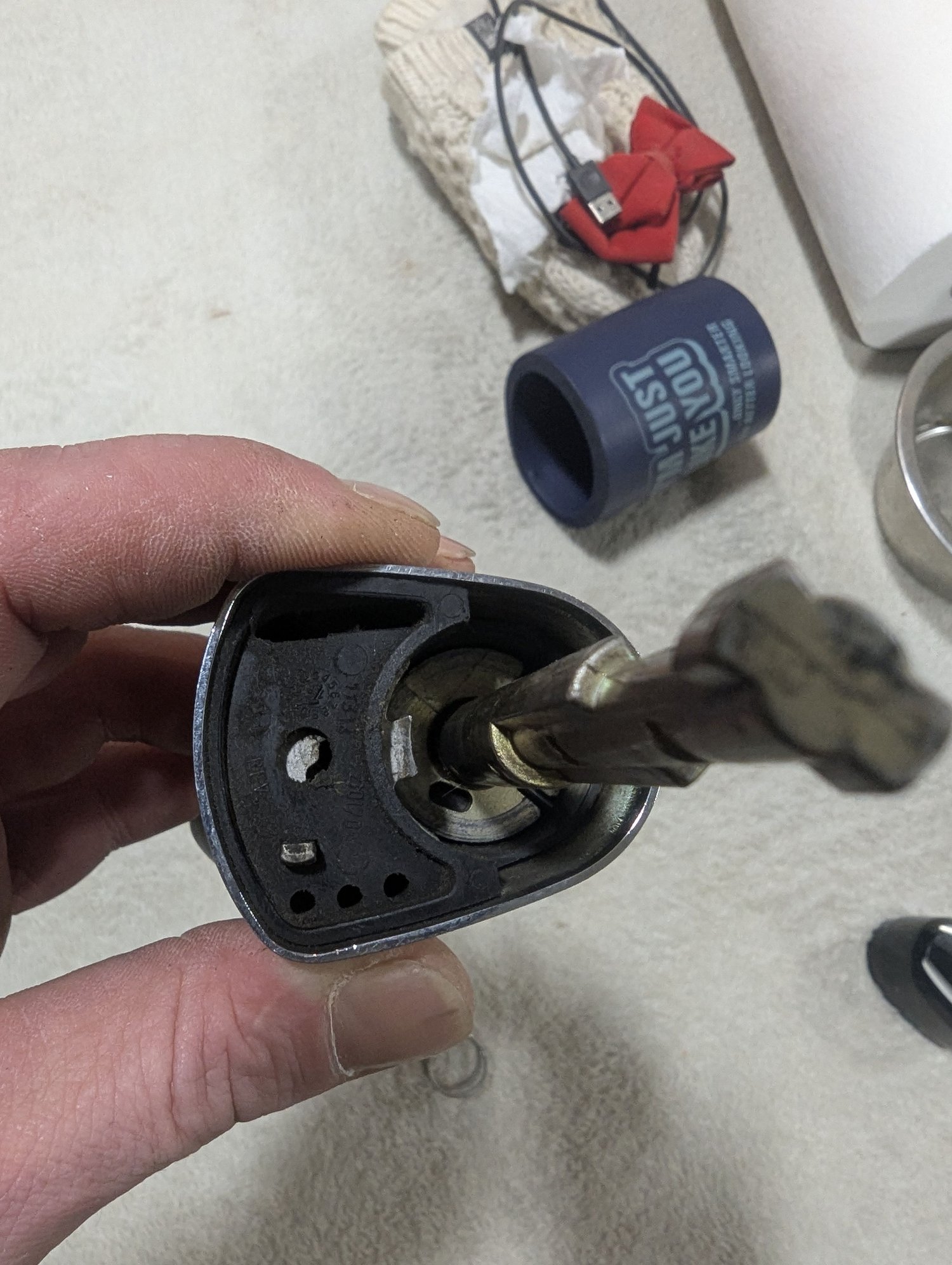

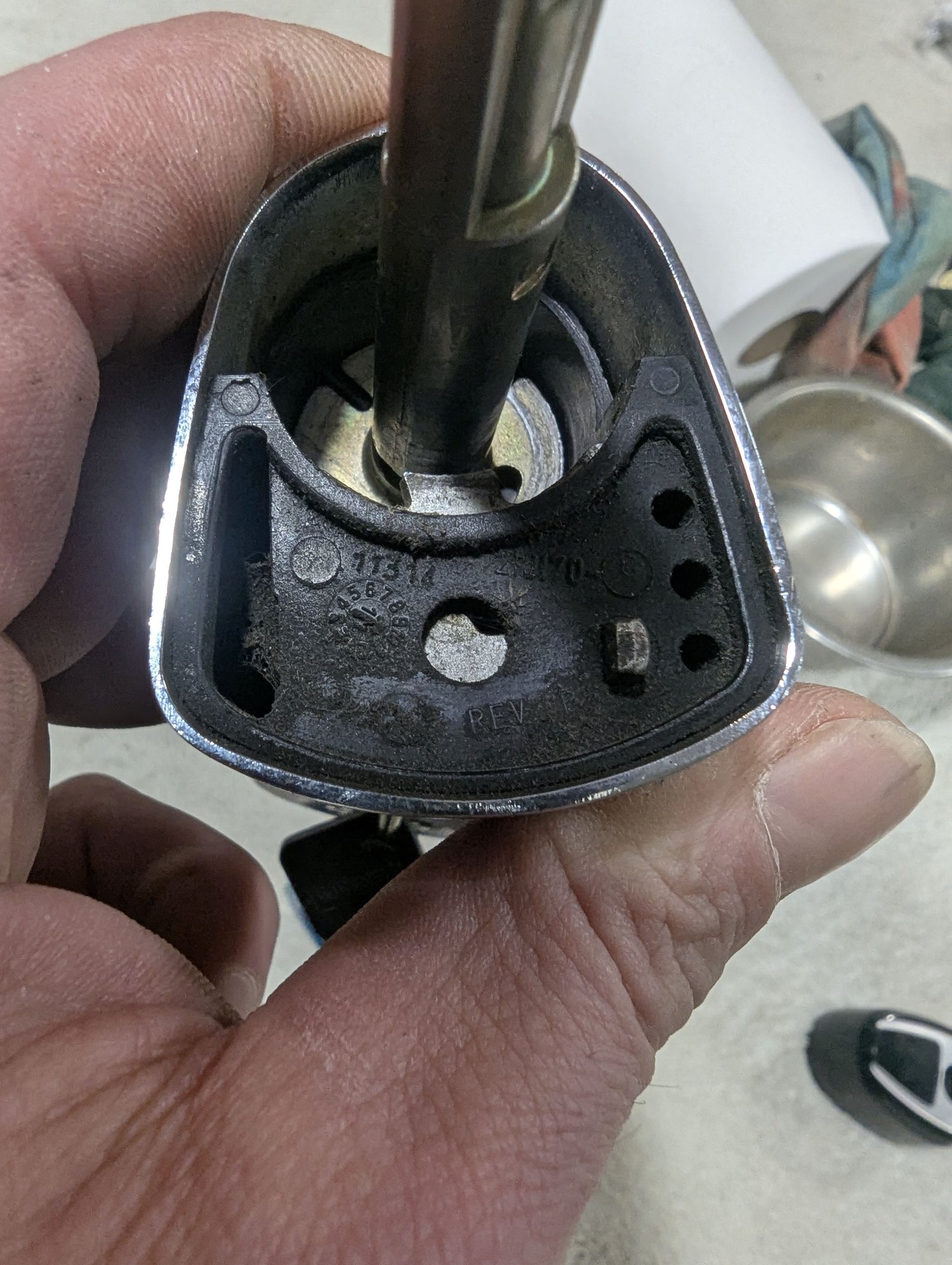

Turning the key counter clockwise while pushing the button pulls the latching mechanism back. Turning the key clockwise pushes the latching mechanism out further. When in the unlocked position the latch is in a middle state, holding the ignition in. The button must be pushed to turn the key fully counter clockwise.
Key in the middle
Key in the middle
Key turned counter clockwise
Key turned clockwise
