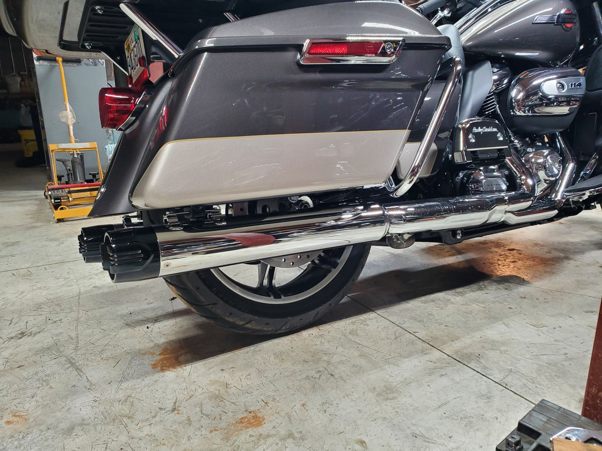

As I understand, (from the service mgr at my dealership) you can change either the exhaust or the air intake without a tune. If you're changing both, a tune is required.
I wasn't crazy about the look of the stock mufflers on my 2020 RGL either. Look for a set of CVO "take-off" mufflers. That's what I have ended up with.
Similar sound to stock...maybe a bit more "throaty". There's plenty for sale on eBay, etc. (or on the Forum Marketplace here) at very reasonable prices. Think I paid less than $200 for the set and they looked like new.

Yeah I forgot about those CVO take off mufflers, and I have a set in my basement! I think I paid less than $200 for them on Ebay and they looked like brand new.
Basically the same as stock but with a different look that some may like better.

The M8's do not need a tune after upgrading the air cleaner or exhaust.
Unlike the Twin Cam's the M8's do not come from the factory overly lean and do adjust to change a bit on their own.
With that being said, you would see a benefit in getting a tune after getting these upgrades, but it will not harm the bike to not get a tune.

Can you? Sure. Should you? Debatable. Harley wisdom dictates that stock bikes be tuned because they leave the factory tuned for EPA requirements rather than power, cool running, and/or longevity. A mild canned tune should probably be everyone's first mod; it's certainly encouraged.

Tuner definitely helps the 103's
