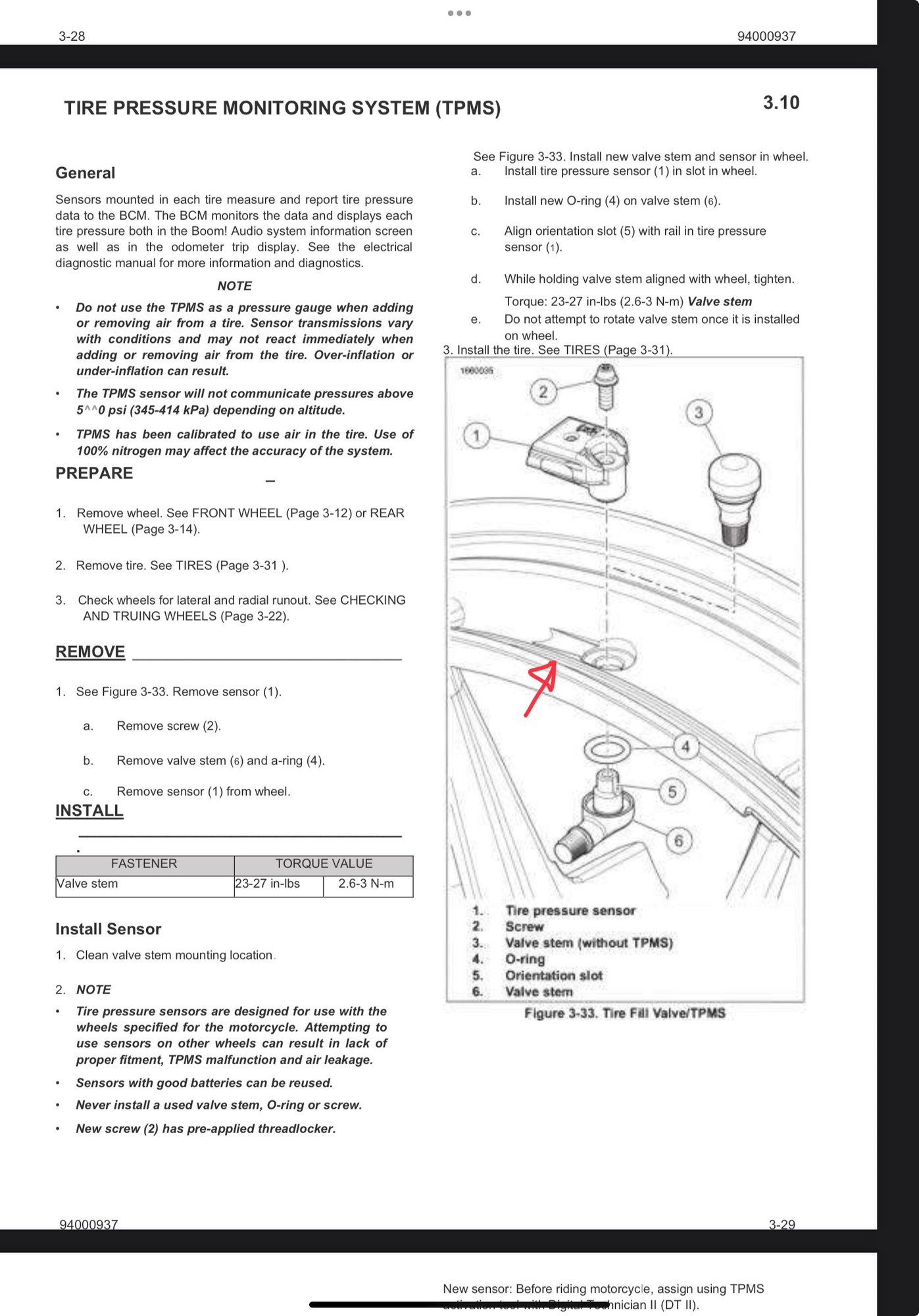

I have a set of OEM Turbine wheels, non-TPMS. I want to install the TPMS sensors from my OEM Slicer wheels on the Turbines…
I’m thinking the Turbine wheels may not have the sensor slot (see image Figure 3-33)…
Would that be an issue? Is there a workaround (w/out doing modifications to wheel)?
