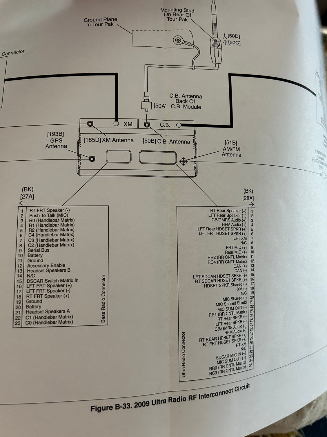

2 speaker set up
Pin designation. Plug 27A is the plug where all the radio controls terminate to

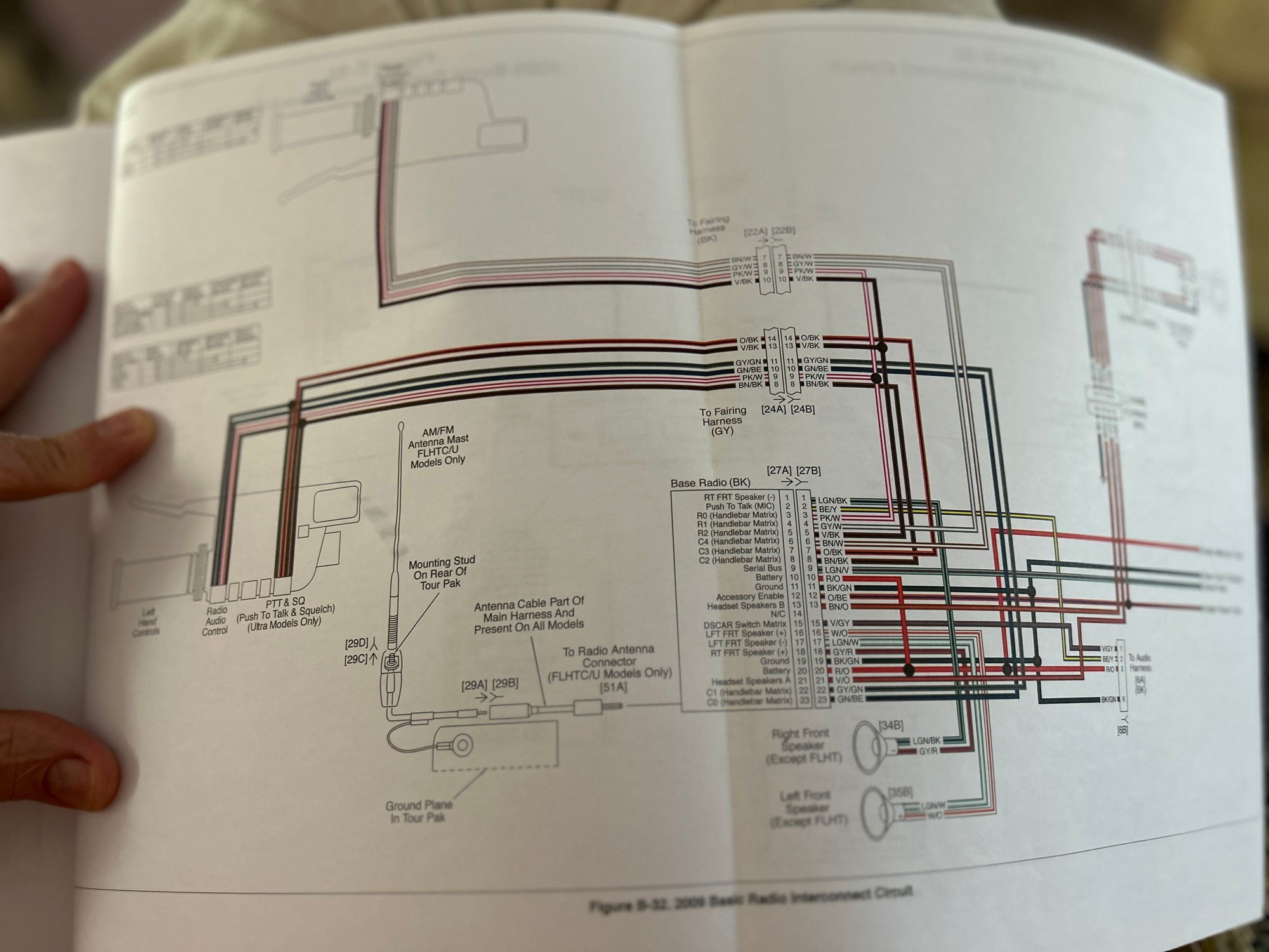

The radio was bench tested at Crutchfield and it worked perfectly so I took your advice and got ahold of Boss directly. I got ahold of Boss tech support and they were absolutely zero help. They couldn't even get me a pinout diagram from their own radio. I did figure out the radio was locked on Aux mode causing every function on the radio except for the volume to not work. After a ton of probing and schematic chasing I found an input to the radio coming from the rear radio controls on the tour pack for push to talk. I cut that wire and everything on the radio works perfectly now. The circuit must have shorted somewhere causing it to send a signal all of the time. I don't use the rear control anyway so problem solved! It still makes no sense why the factory radio worked perfectly? Thanks for everyone's input on my problem.
