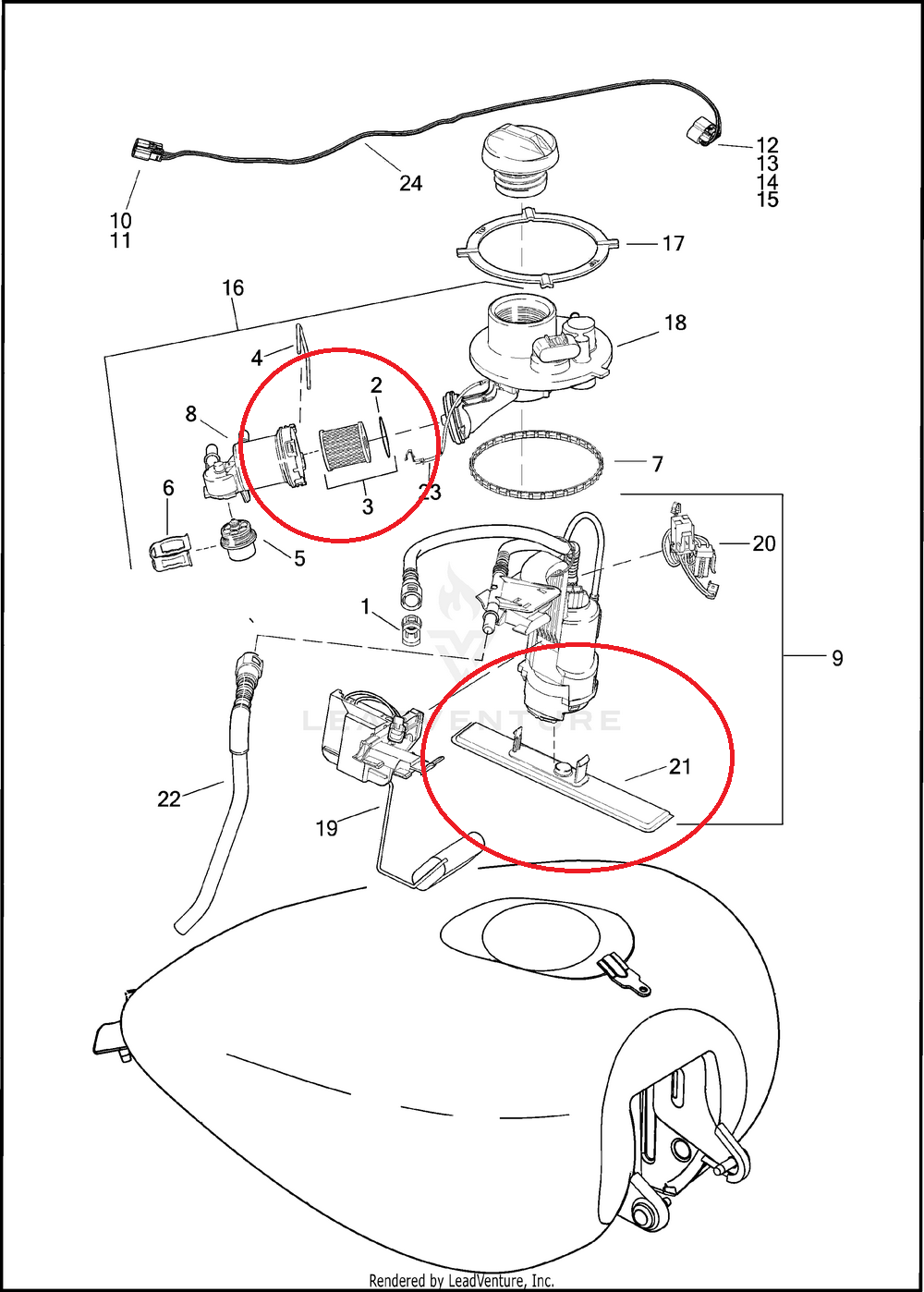

When was the last time you changed your fuel filter or fuel pump inlet strainer?

The description you give, sounds like it could be a fuel restriction issue. Fuel filter suggestion sounds like a good thing to check... Do you have access to a fuel pressure gauge to check the fuel pressure at the tank valve?
Thank you. I was thinking the same thing. I will post what the filter looks like when I get the new filter. I just wish this was an easier fix, lol
Not a hard job, the only trouble I had was with part #4. That clip was a PITA to get out and put back in. Once you get the filter unit out, put a shop towel under it so as not to drop any parts in the tank. Also best to run the tank down as empty as possible.
Hope it works for you.
