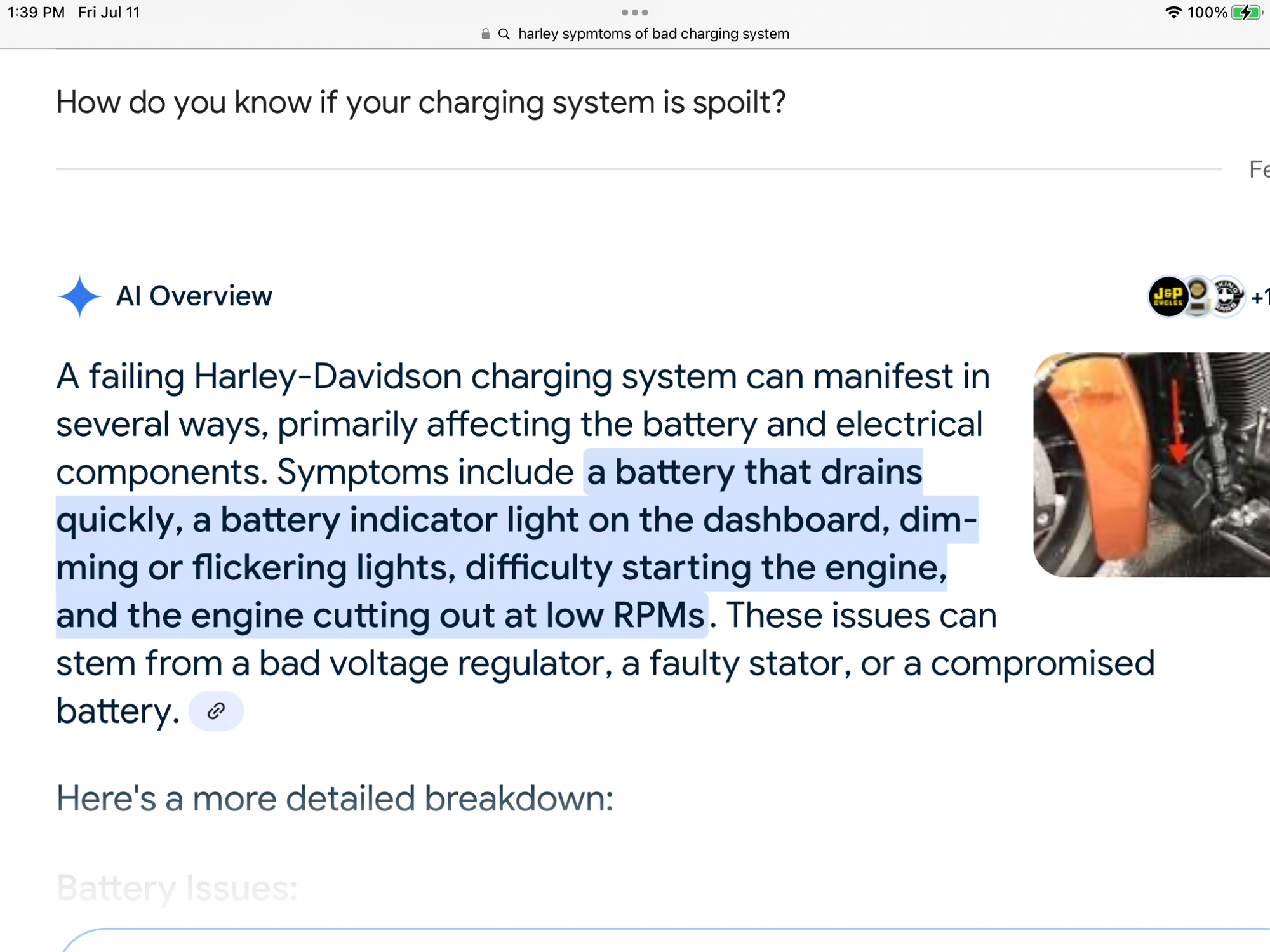

Based on the symptoms I’d revisit the charging system.

I will have to research it a bit, but will do it. Just an FYI the bike was doing this last year. As a heads up, I have a brand new battery, VR and stator in the bike. I replaced them around two weeks ago as the VR went bad.
