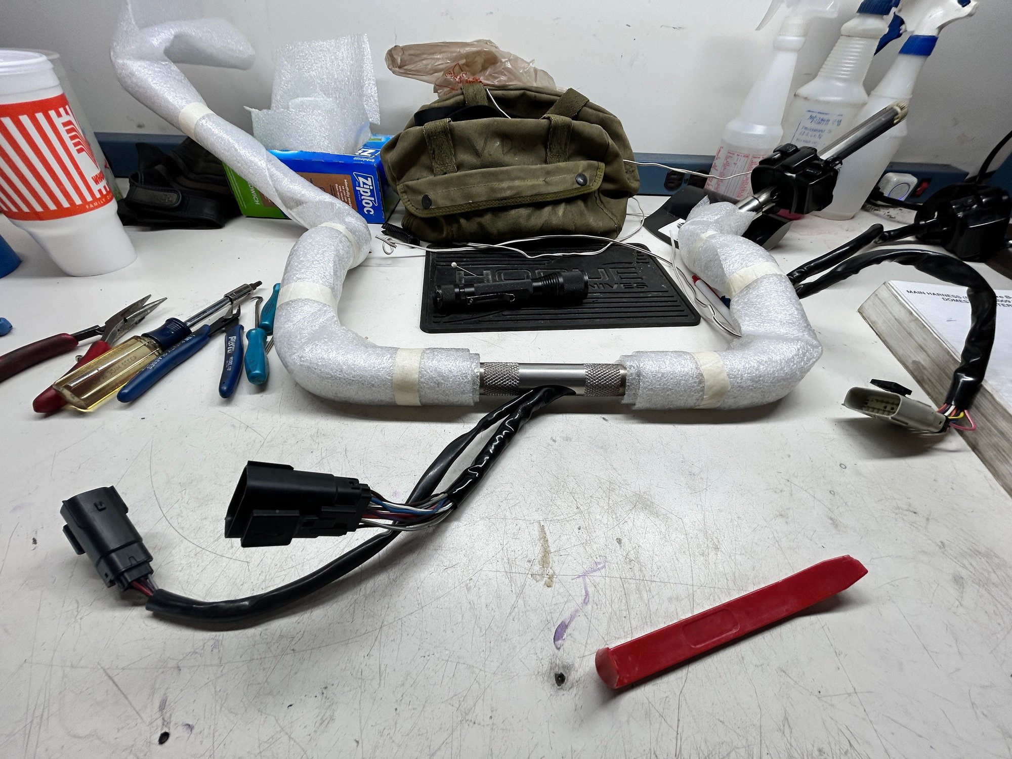

Got the bars yesterday. Removed the old bars. Started the wire migration to the 10". I was going to remove the vinyl harness loom cover and just run the wires. My inner voice was telling me to try it with the vinyl wire loom. It took a bit of patience but I got them in. The clutch side should go a bit easier
This concludes the break side wire harness install. The pins were fun (sarcasm) 😱. Man, I remember replacing a 60 pin over head console plug in a UH60 that was easier to install. But that was when I was young. 😀

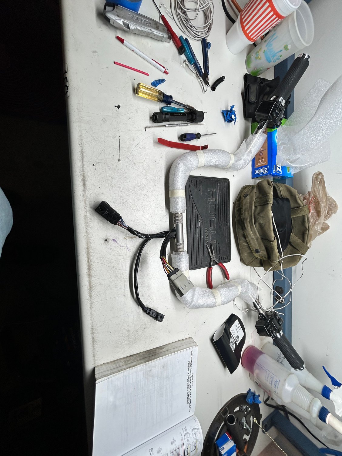

Fed the clutch side through. I'm done for the night.
Here is a pic of the bars ready to be installed.
TA-DA!

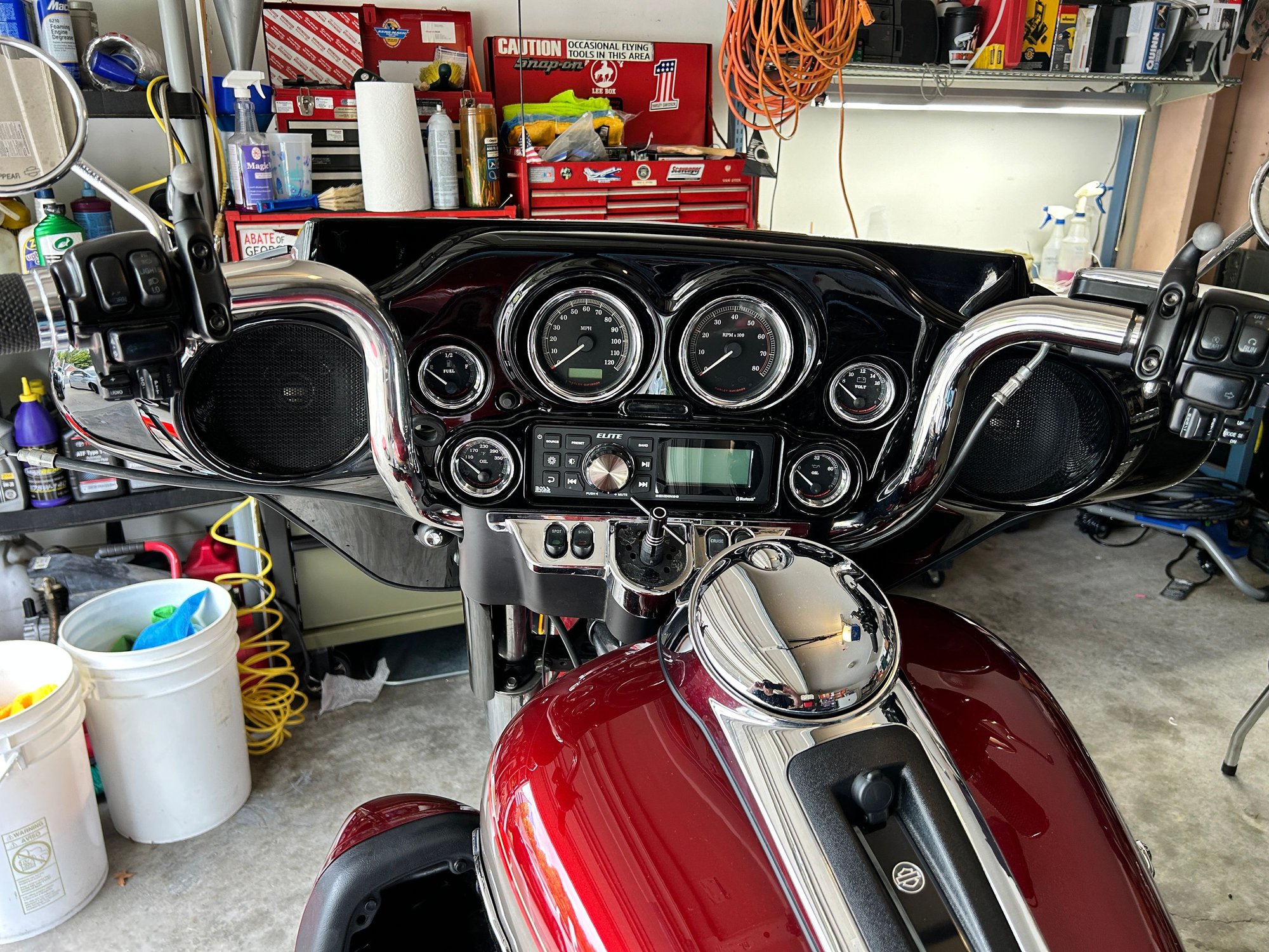

I finished the installation of the KST 10" 6 bend bars.
My only issue now is the clutch cable. I can't seem to find a way to rout the cable where I like it.
I'm looking for something that looks like stock if and not like a some hay seed goober stuck it on the bike.
So now I'm thinking of getting a +4 or a +6 inch cable.
So, what do y'all think?
Here is a pic of it so far.
Looks good! Hopefully they feel good to you.
I installed 12” KST Six Bends without a cable extension on a batwing, but I used all the slack. The 10” install that I settled on was no problem, but my 2020 batwing was two bikes ago and I can’t remember exactly how I relocated the clutch cable. KST has good install videos. I recall cutting some zip ties to free up the clutch cable, and I may or may not have removed it from the cable tray on the right side of the neck of the frame, if it has one. I definitely did remove it from the cable tray on my 2024 Road King police.
I installed 12” KST Six Bends without a cable extension on a batwing, but I used all the slack. The 10” install that I settled on was no problem, but my 2020 batwing was three bikes ago and I can’t remember exactly how I relocated the clutch cable. KST has good install videos. I recall cutting some zip ties to free up the clutch cable, and I may or may not have removed it from the cable tray on the right side of the neck of the frame, if it has one. I definitely did remove it from the cable tray on my 2024 Road King police.
I've watched the KST videos, some of it was frame by frame so I could see it all. I even went to KST to see how they routed the clutch cable. I did not like it. I want it to look nice, like it is supposed to be there. I'll keep looking.
