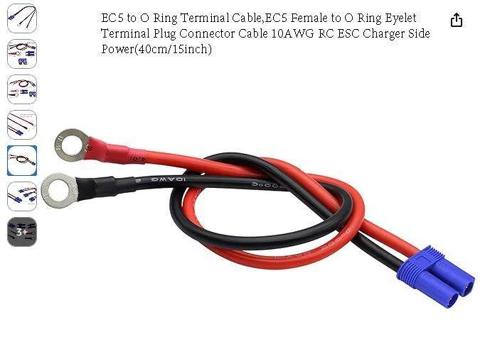

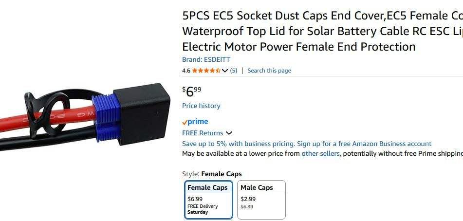

I like the concept. So one would permanently attach the leads to the battery terminals and then stow the plug somewhere, like under a side cover? Assuming you have one installed, can you post a pic? Is there a cover for the receptacle? Which charger model do you have? I happen to be looking for a new jump starter for my SG.

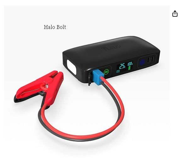

I added this pigtail direct to the battery on my Ultra Limited as well as my Pan America. On the Ultra, the connector exits the side cover where the tender pigtail comes out. On the PA, it is just in front of the shifter. Cheap, and has saved my a few times when the cold weather has made starting difficult. I carry a small Halo Bolt with me for various uses.
Cheers

The advantage is it is quick. The jump pack should be smart enough not to reverse polarity.
I don't think this is a must have. I just felt like it
It can replace tender cord. The one I bought came with adapter to plug tender in
