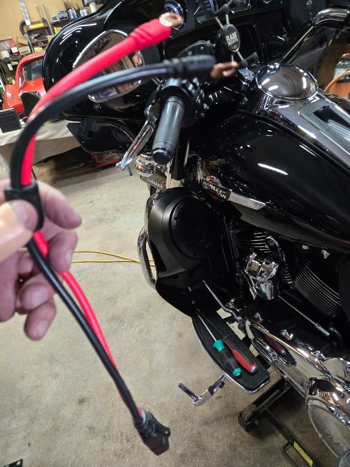

I hooked up one of Noco's jump cables. It goes directly to the battery; the end is designed to plug into a Noco boost .
You can quickly jump your bike without going off the starter . Would this not eliminate the problems everyone is speaking about ? Or..... will it back feed thru the system ?

Going to the starter main Stud for a connection is NO different than going to the battery itself. The problem comes fro trying to use normal size automotive jumper cables as the ends are too larger for the battery connection let along the starter Stud. You just have to be careful and use a little common sense in either case.
