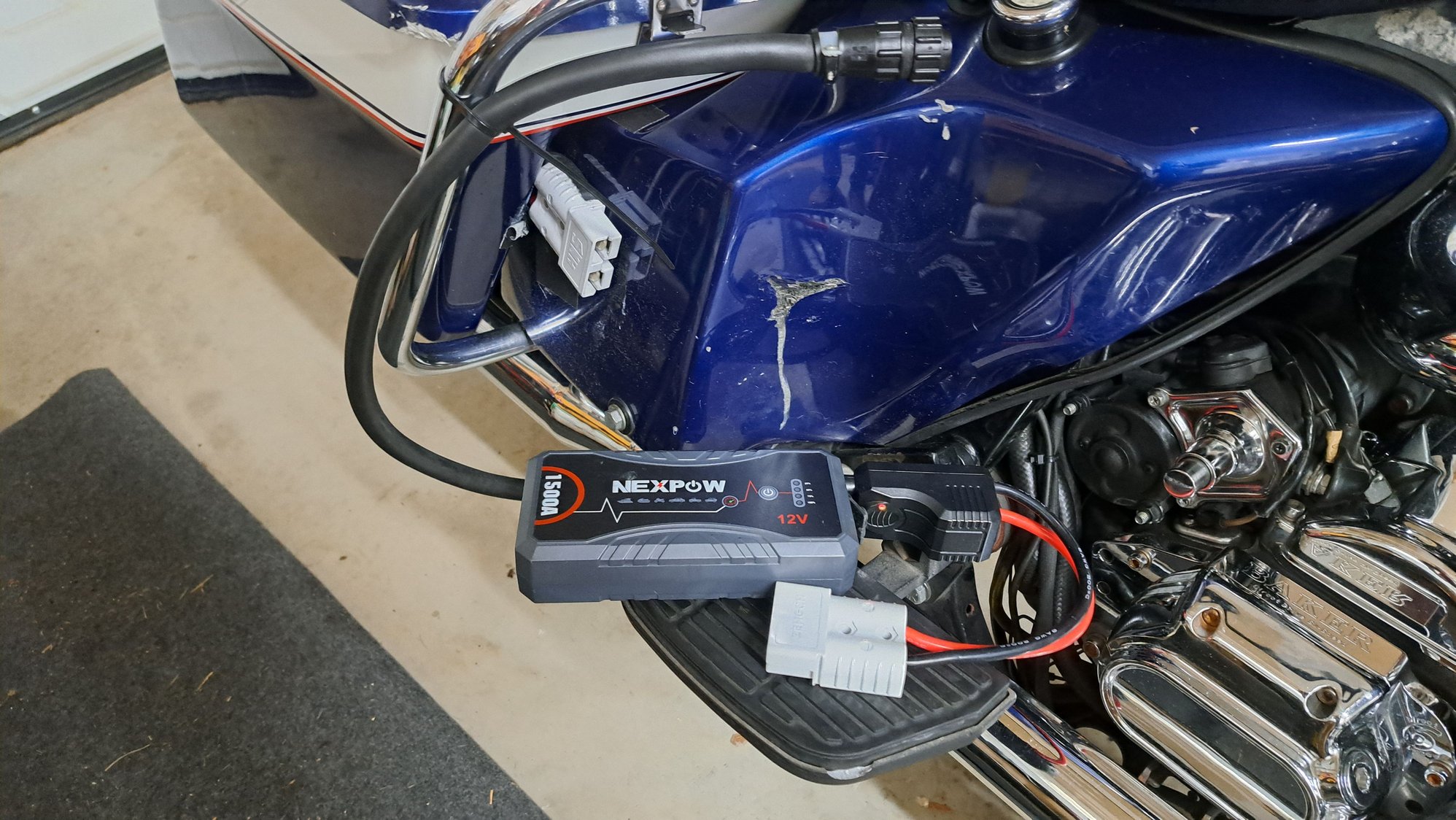

I was told when I bought this bike in 1989 to never jump it from a running car so this is not a new thing. I have a direct connection to my battery for use when the sidecar is attached. There is a car battery in the trunk of the sidecar so I disconnect the onboard battery when connected. I am part way thru the second year with my NOCO lithium battery. I also carry a jump pac which I used at first with the AGM HD battery to boost the start and now it comes in useful to reset the NOCO if the BMS decides it doesn't like the surge if I bump the starter twice in a split second or so and disconnects the juice. The plug is good for 120amps I think the last time I checked starting current it was around 80 amps. that dam 1989 starter
