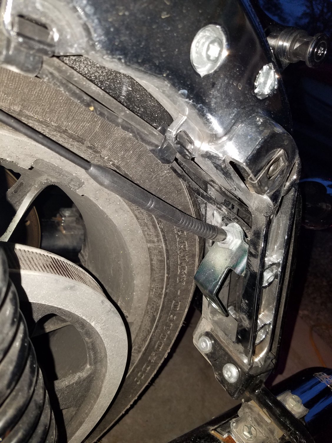

Default Antenna Mod
One additional thing i did when hiding the full-size factory antenna under the seat. I modified the factory mounting bracket to rotate and secure the base of the antenna in the stock mounting hole.

How is that setup working out for you?
I did it once before and got poor reception, but i didn't mount it using the bracket. i just used a couple zip ties. I wonder if that makes a difference? Maybe like a ground??

No issues with reception for me. I heard that bolting it back up keeps reception the same as factory.....and besides the clean look, it is nice not getting whipped in the face anymore lol
