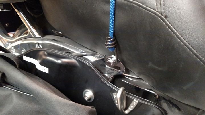

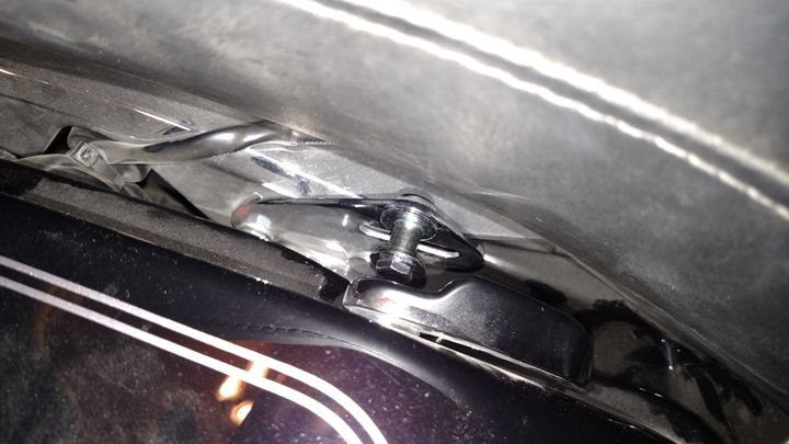

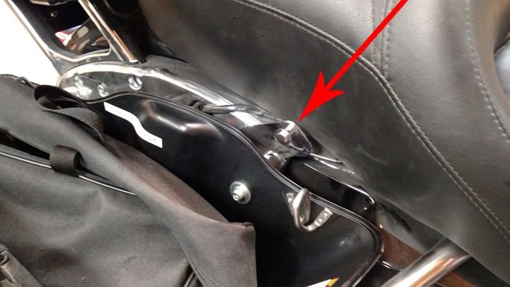

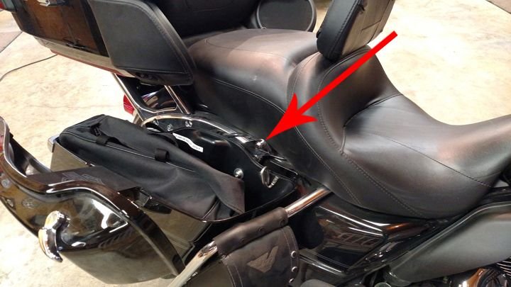

I did this on my 2015 Ultra Classic. Since the bike does not have the metal passenger grab rails that makes it easy to bungee stuff down on the passenger seat, I decided to fabricate something of my own. I took off the "leather" grab strap from the seat by removing the two screws at either end. Then I acquired 2 chrome bolts (1/4" X 20 thread, 1" long) and 2 spacers (1/2" long) and 4 chrome washers. Stainless bolts would have been better cuz I find that the chrome bolts are often a tight fit and can bugger up the threads. I guess it's because the chrome plating makes 'em a tiny bit bigger? Anyway, I ran a die over each one to clean up the threads and they worked fine. Below is a description and a number of photos. You can alternatively go to my wildly popular (cough cough) website and see it there. (OK...so I get only 2, maybe 3 hits a week on my website. One of these days it'll catch on.)
Assembled them like this, and squirted a bit of blue Loc-Tite on the threads.
Threaded each one into the bolt holes vacated by the screws that used to hold the grab-strap. The next 3 photos show where it belongs.
Then I stretched a bungee cord over the seat to try it out. Voila! Works great. Using the 1" long bolt on my 2015 Ultra, there was plenty of room between the head of the bolt and the saddlebag lid. Regardless, if anyone decides to try this mod I would suggest making sure the bolt head won't hit the lid.
