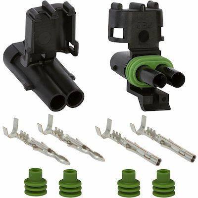

I, like most folks, have a battery tender on my bike. I also just recently bought heated gloves. The kind where you can either run them off of batteries that you put in the gloves or off of the motorcycle battery. Instead of installing a 2nd pigtail on the battery I just cut the ends off of the battery tender charger, battery tender pigtail that goes to the battery, and the pigtail for the heated gloves that go to the battery. In their places I installed 2 pin weatherpack connectors. I already had the connectors and the proper crimping tool.
So now if I want to use the battery tender or the heated gloves (or any other heated gear I may get down the road) it's all interchangeable with the same plug.

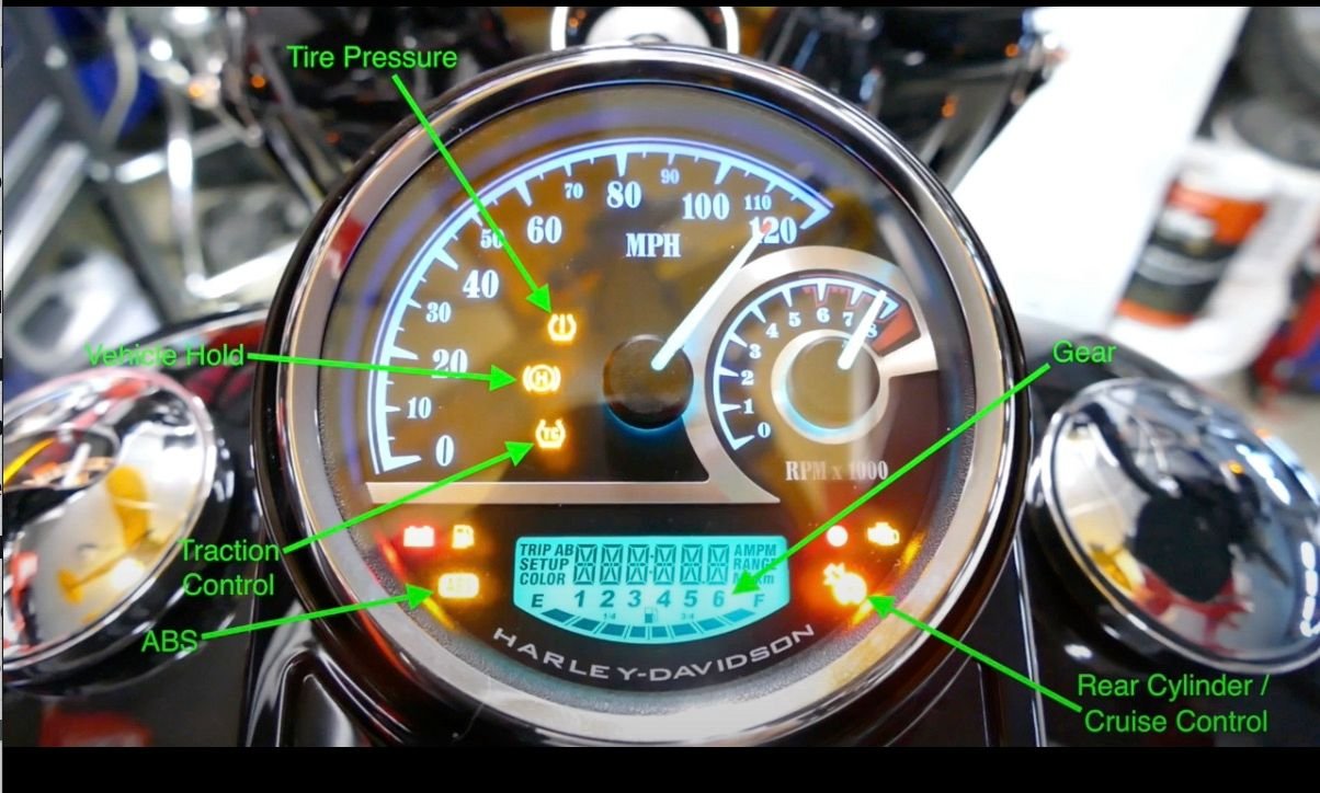

DIY installation of Analog Speedometer/Tachometer on to Road King Special. Mine is a 2020 RKS. I swapped out my stock Speedometer gauge for the Harley-Davidson upgraded gauge. The new gauge has all the function plus a tachometer. In the video, I did a quick comparison between the stock and the Combo Speedometer. One thing I forgot to show was the traction control setting for rain. The new Combo Speedometer does show the word "RAIN" when I switched to rain mode.
Installation was quick and easy, possibly one of the easiest upgrade. However, make sure to get the correct part for your bike. They may look similar but the part number are different for different models. Basically, plug, bind and play
Harley Davidson Combo Speedometer/Tachometer part# 74776-11D https://shop.newcastlehd.com
New Combo Speedo from Harley
Here is the DIY video I did.
https://rumble.com/ve7bzb-installing...iaudh&mc=56lh6
