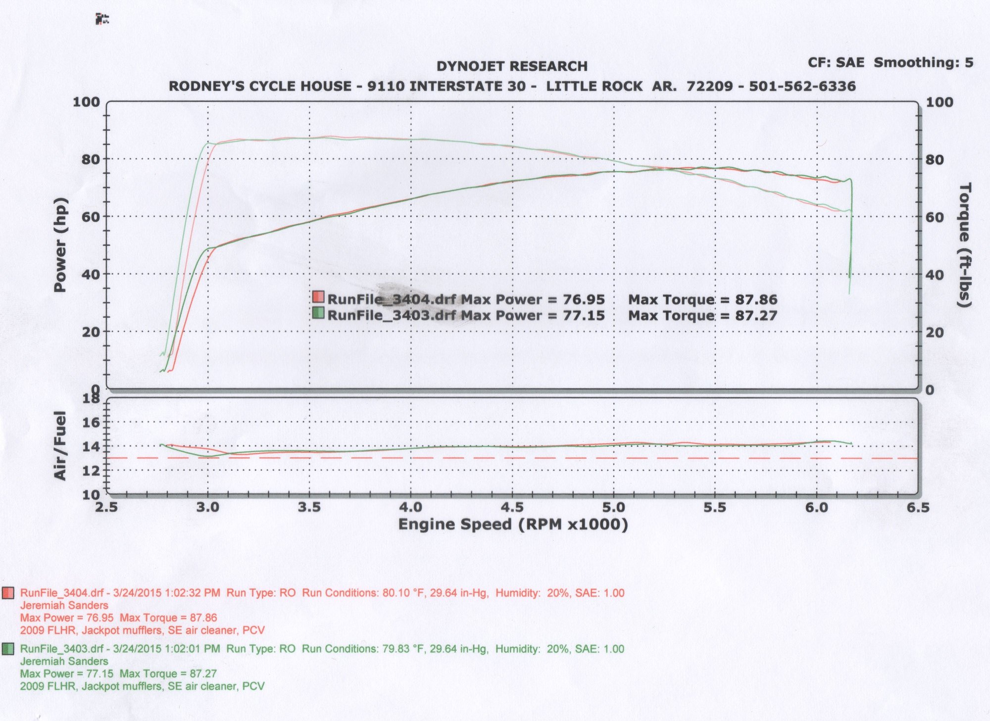

They didn't do a before due to already having a canned map loaded into my PCV. Please give me feed back on how this looks. First time paying for a tune.
PCV, Fuel Moto Breather, 4" Jackpots
