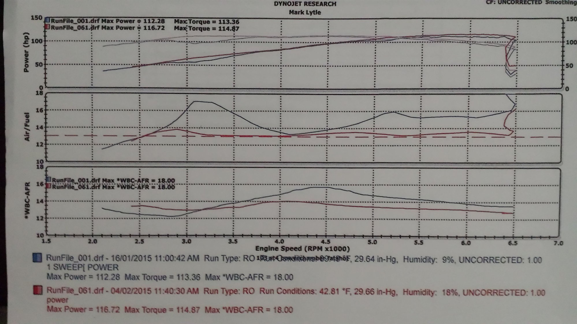

Default 2012 FLHR Stage 4
My 12 Road King, street legal stage 4, V&H power duals with SE fat shots, SE heavy breather, added 5.3 g/sec injectors and SE pro tuner and had it tuned this winter. It took care of a very lean condition with the canned map and picked up a few hp, ended up with 116.72hp 114.87 ft/lbs

That is a good tune you got there.

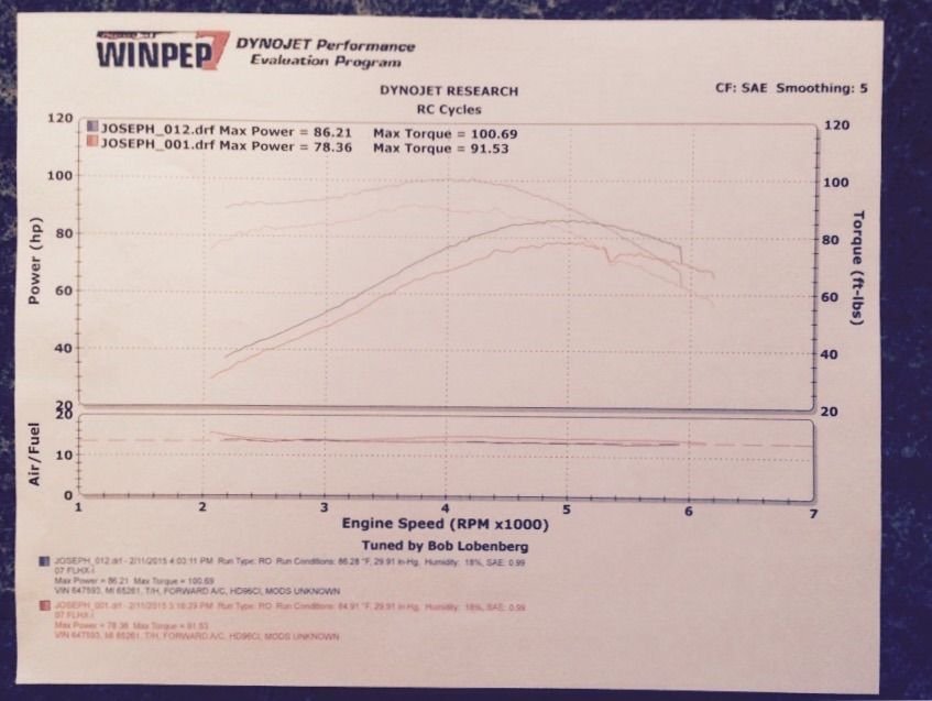

Default 2007 flhx
Not much but here's mine:
Hp: 86.21. Torque: 100.69
Stock 96" w/ unknown "mild cams". In bike when purchased.
DK Custom Outlaw 636v intake
Cobra true duals w/ thunder header thunder cones
And now tune by bob @ RC Cycles

Very nice run and build. I see you're from Ottawa, may I ask who did the build and tune? Congrats on a great running bike.

Sorry, forgot to mention the question was directed to ml103, and his stage 4 build. Thanks
