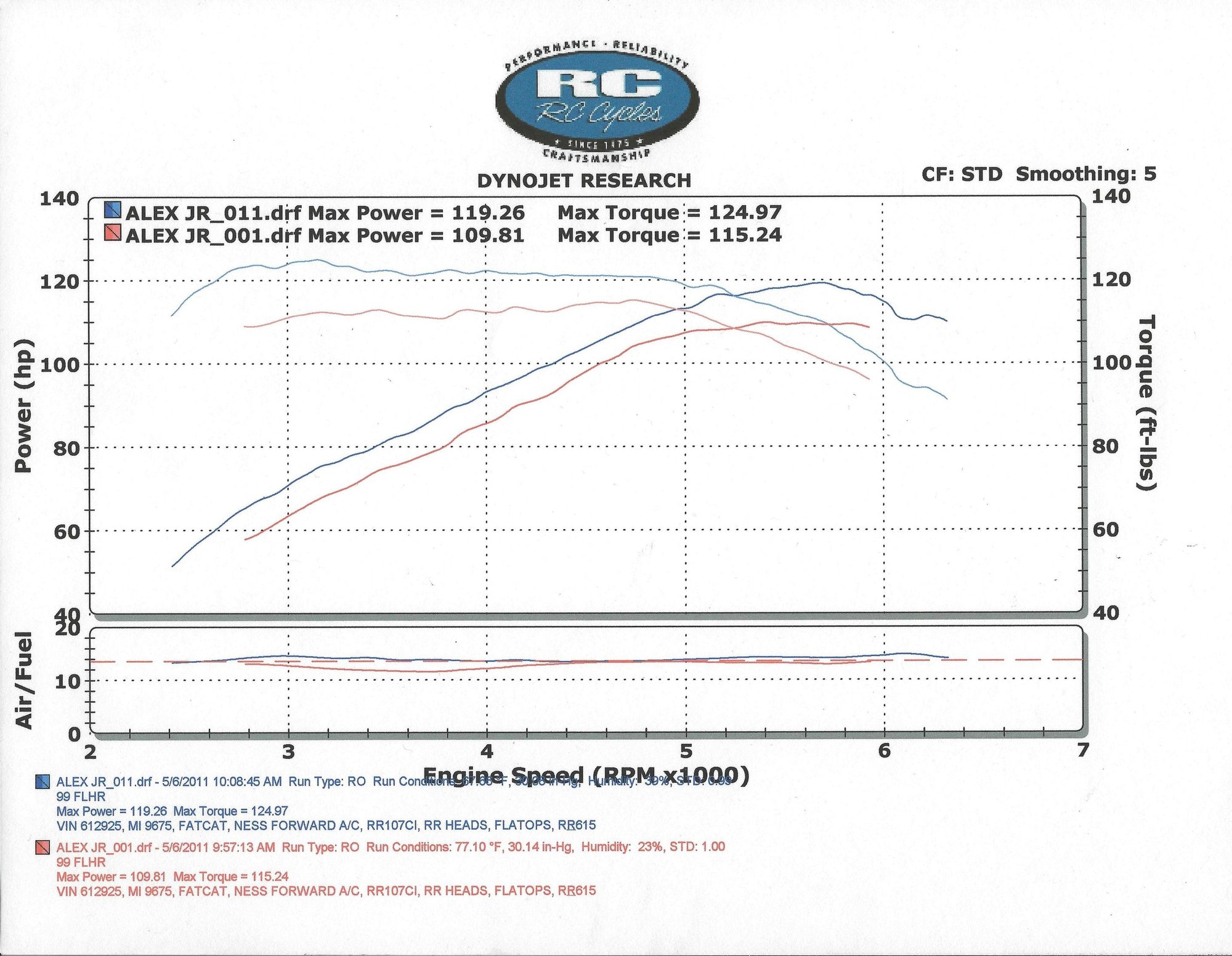

Default 1999 Road King with 107"
Here is the run from my old Road King with a little 107"....''
