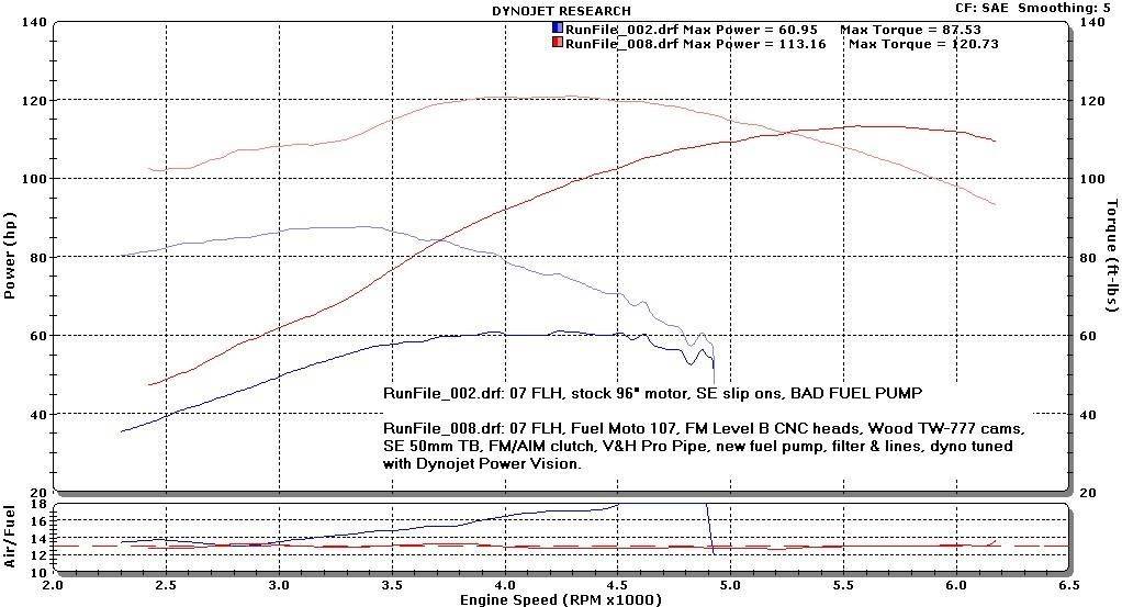

Fuel Moto 107" Big Bore build. 2/24/15
Built by Fuel Moto USA, 107", Woods 777s, Level B heads, V&H Pro Pipe

Good to see you went with the whole package including the heads Steve. I bet you can't wait for the weather to turn.
