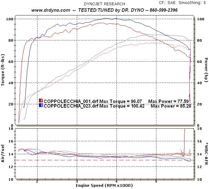

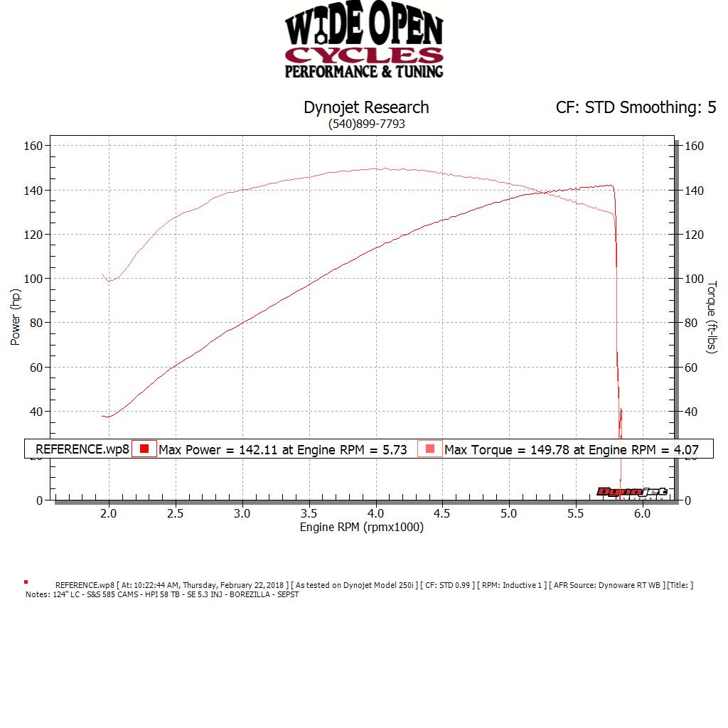

Here's a good example of the differences. The first one is shown in SAE, the second in STD
Attached Thumbnails  DYNO Numbers for Baggers???-lars-124-lc.jpeg    DYNO Numbers for Baggers???-lars-std.jpeg
