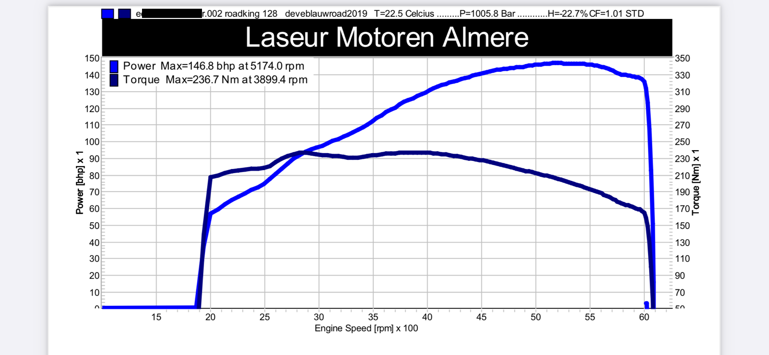

These are the dyno numbers I got back from my tuner. They're unbelievably high, with "unbelievably" being the operative word here.
This dyno is probably very happy, and the actual numbers on a calibrated dyno are likely 10-15% lower.
The bike was tuned with the Dynojet Power Vision 2.
The actual dyno sheet provided by the tuner:
Data manually converted to freedom units for easy comparison with US dyno sheets:
If I come across an opportunity to do a dyno run for free on another dyno, I will do it. I'm not, however, going to pay a different dyno-guy just to see how much this chart is off by.

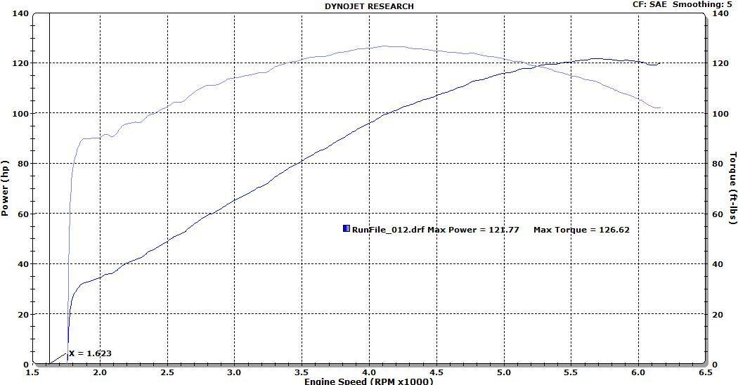

S&S 106 Hot set, D&D Fat Cat 2 into 1 exhaust, HD SE Chisel air intake, Stock Heads.

That's close to what I get out of my 103 Stage IV with V&H Pro Pipe 2 into 1...

If that's all your getting out of a stage IV 103, then you need to find a new tuner.

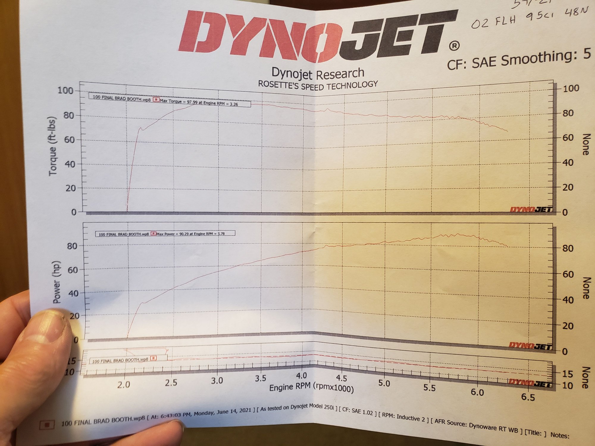

I call this the Rad Ripper.
95ci cp pistons bored jugs and intake by hillside cycle & his stage two heads ,48N, bassani two into one. Finally found a good tuner Big Fins customs in farmington hills

Yes, that looks like a very good tune for your build...

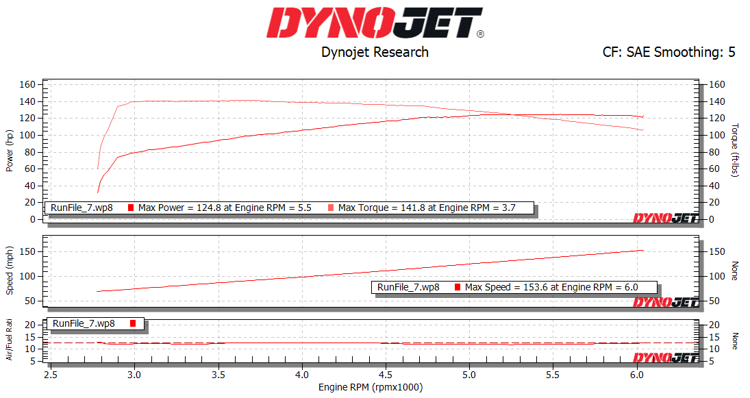

2018 FLHR | S&S 124 | 550 cam | V&H Pro Pipe | Big Sucker

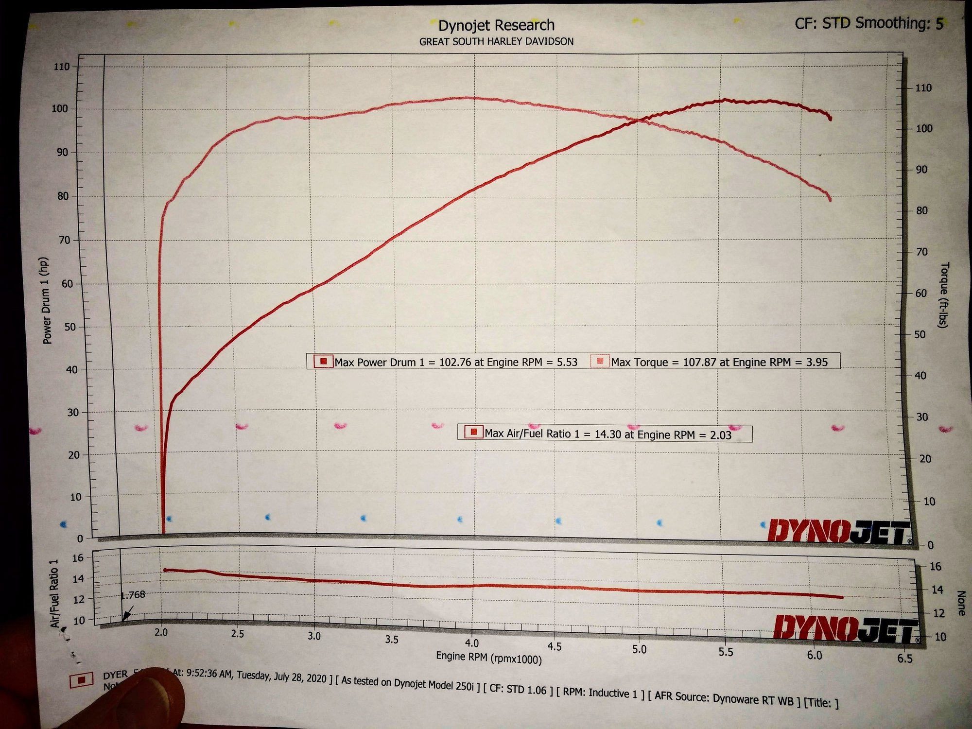

Here's the Dyno from my cam package upgrade - intake/header/cams/tune:
