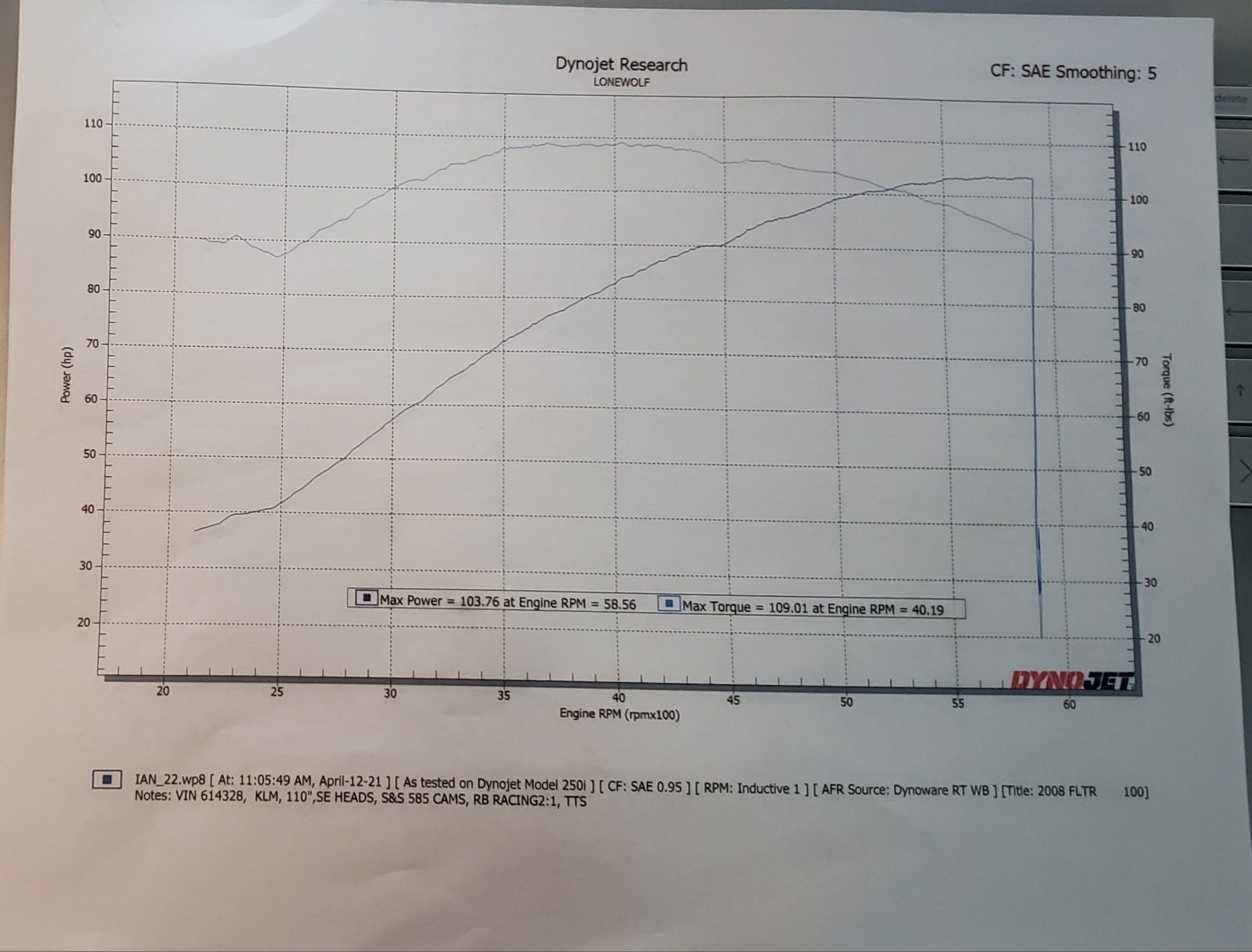

I had my ol Twinkie on the dyno last week, TTS Mastertune by Lonewolf Performance. I previously had a FP3 on there and all those things do is dump a lot of gas, this new tune was 20-25% less gas through every cell; I now have compression upon releasing the throttle again.
Screaming Eagle 110"
S&S 585G EZ Start cams
S&S cam plate, oil pump, push rods, tappets
Trask Air Assault
RB Racing Spyder 2:1 exhaust
Stock injectors and intake
Pulled 104hp and 109tq - good enough for this cruiser.

That's about what I get out of my 103 Stage IV...

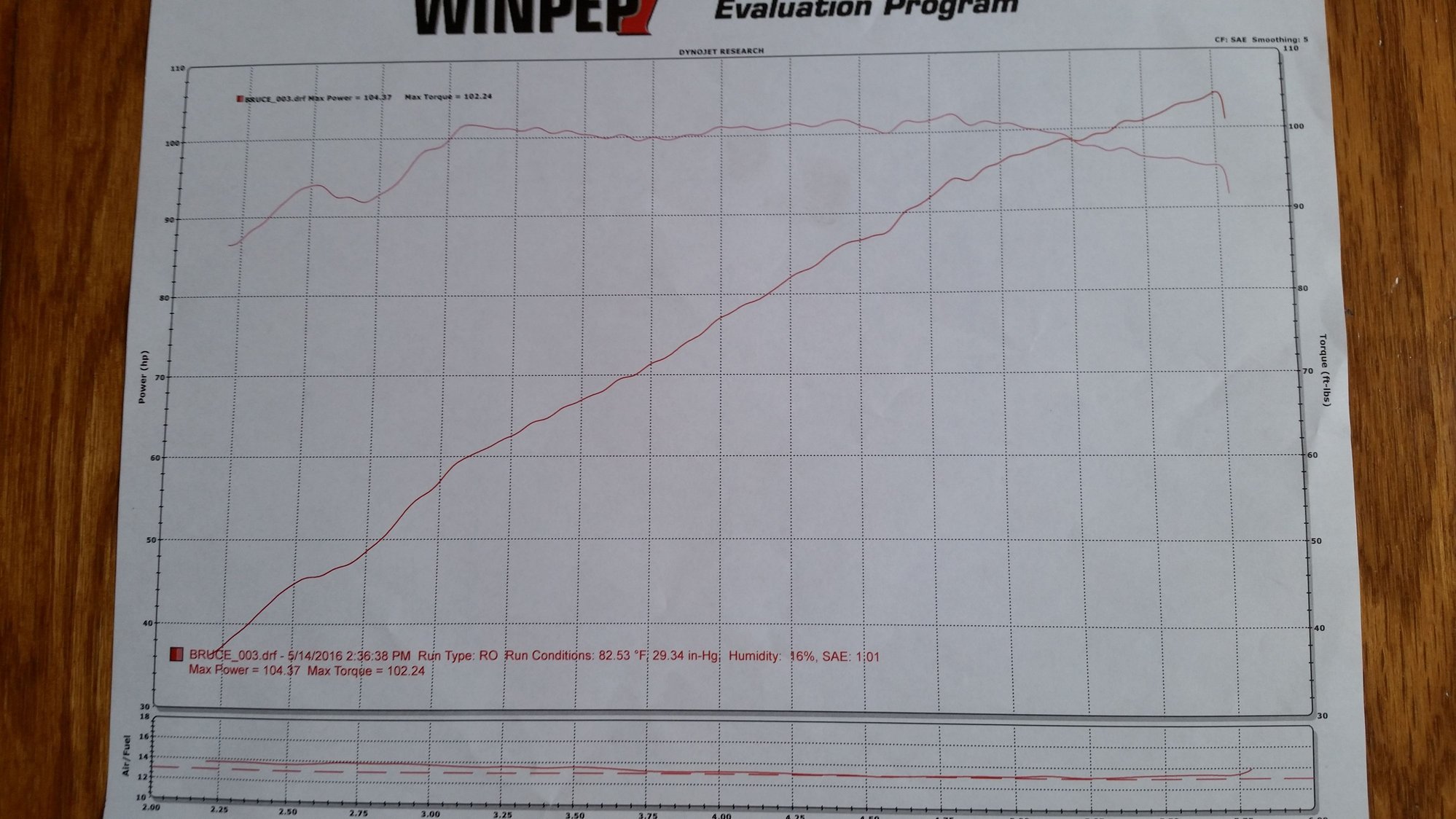

2013 FLHTK 103" Stage IV...V&H Pro Pipe. I really like the strong, steady torque line...pulls like a freight train...

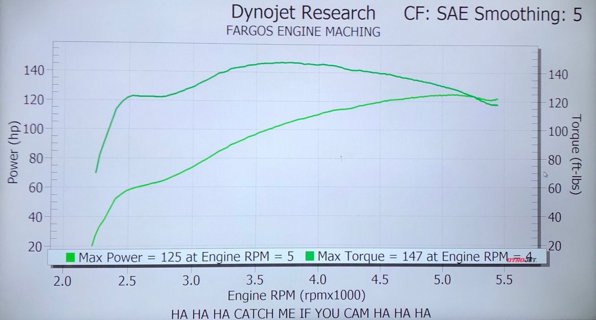

Default Carbed 124 Dyno Results
ust got the dyno results back.
2002 Case bored
s&s 4-5/8 crank welded, balanced
s&s superstock 89cc heads ported
woods tw9bg
solid lifters
super g carb with oversized filter
ported manifold with YOST Performance spacer
FAB28 2-1 exhaust 1-3/4 to 2" primaries with 2-1/4 merge collector and muffler
125hp/147tq
If you look at the chart you can see where the exhaust is choking the motor. Right around 4300 rpm. FAB28 is hooking me up with a 2.5" merge collector and muffler. We are also pulling out the solid lifters and replacing them with hydraulic. Should push the hp in the 140-150 range. We are also going to try a Boarzilla exhaust and see how the numbers improve. Should be fun to ride until we upgrade the exhaust. Tons of torque.
