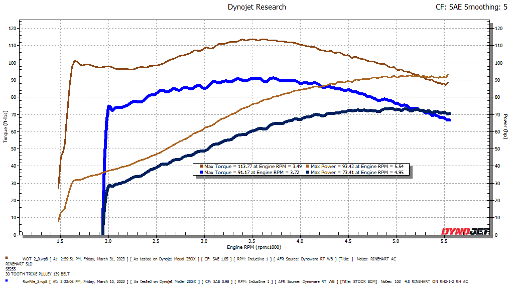

This is a 2013 FLHTCUI that we added a set of SE255 cams and changed his gearing (30 tooth pulley & 139T belt)
before & after.

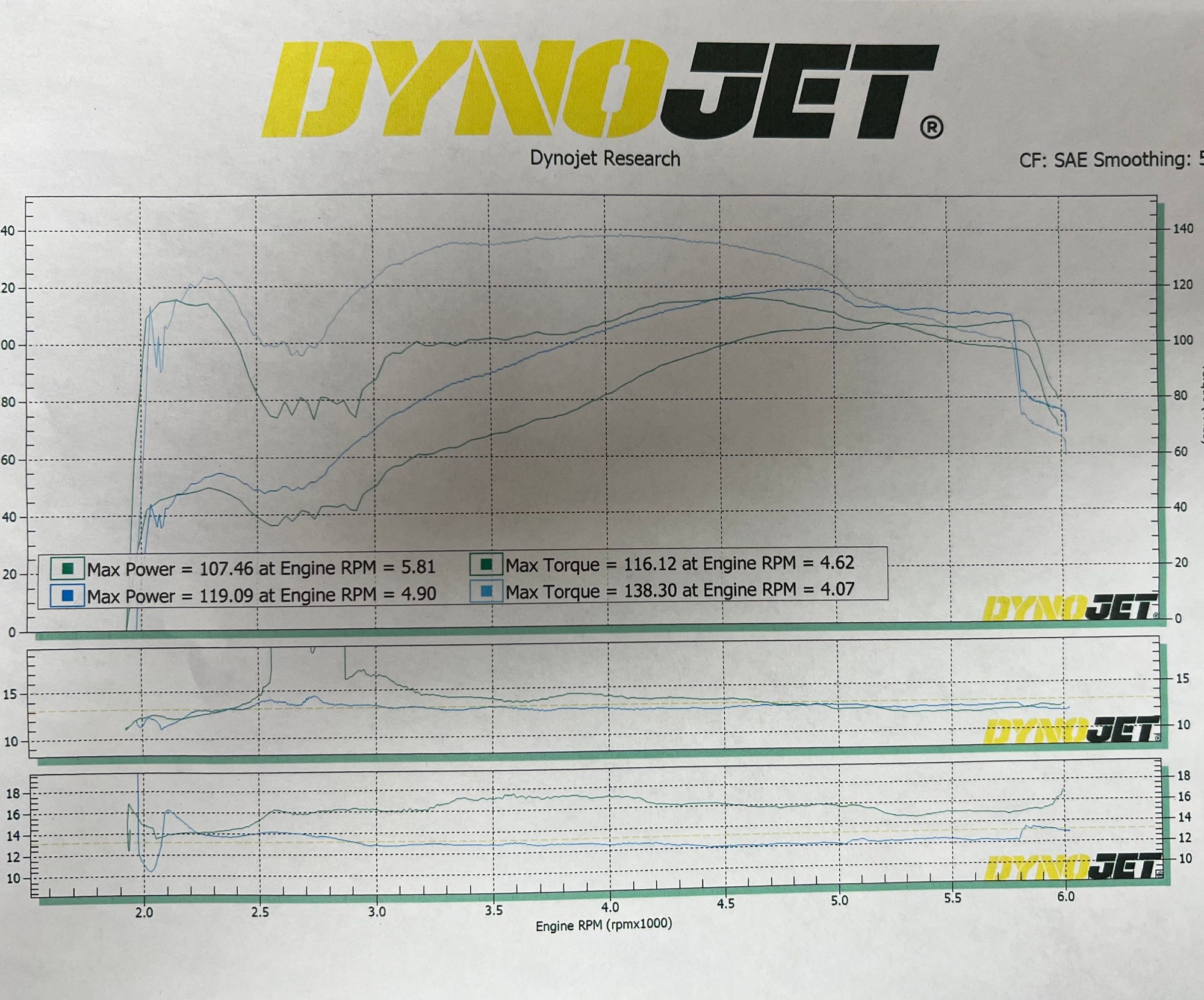

Guess I’ll be looking into 2-1 pipes now. 131 with Woods 77x cam and Rush Racing 2-2 pipes.

Did you use a Goodyear Falcon or Gates drive belt for a 139t? Heard too many horror stories of breakage, but thought of going that route instead of the swing arm mod.

Gates belts are available through Drag branded BDL. I have had great luck with them. The S&S belts are my first pick, but sizes are limited. The Drag brand belts are Goodyear Falcon SPC and I do not recommend them. Belt's are such a PIA to replace it's not worth saving a few bucks.
If you have a band saw, and a guide, you can buy the S&S 1.125 x 139 belt and trim the edge .120".
