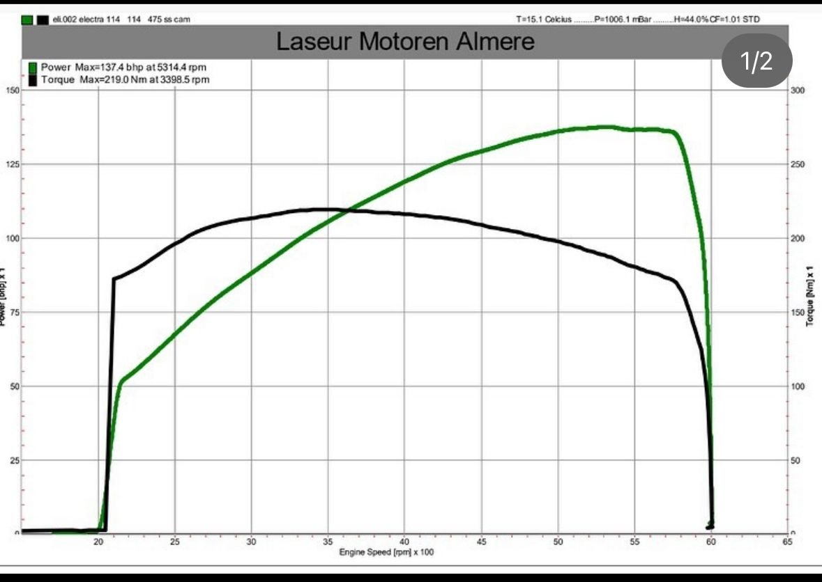

Trask assault filter
v&h power duals + oversized 450 mufflers
s&s 475 cam
137 bhp
219 NM (not ft/lbs) torque
s&s 475 cam
137 bhp
A. that's engine figures, our American brothers use at the wheel
B. that's metric (they might not notice it)
C. it's seems like very happy dyno to me (HP)

161.52611 Foot-Pound (ft∙lb)

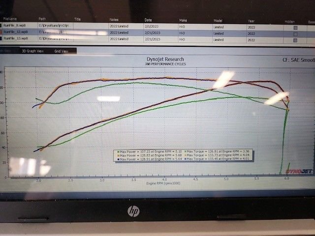

Default 2022 Limited, 114 22XE cam.
All the work done and tuned by J&B Performance.

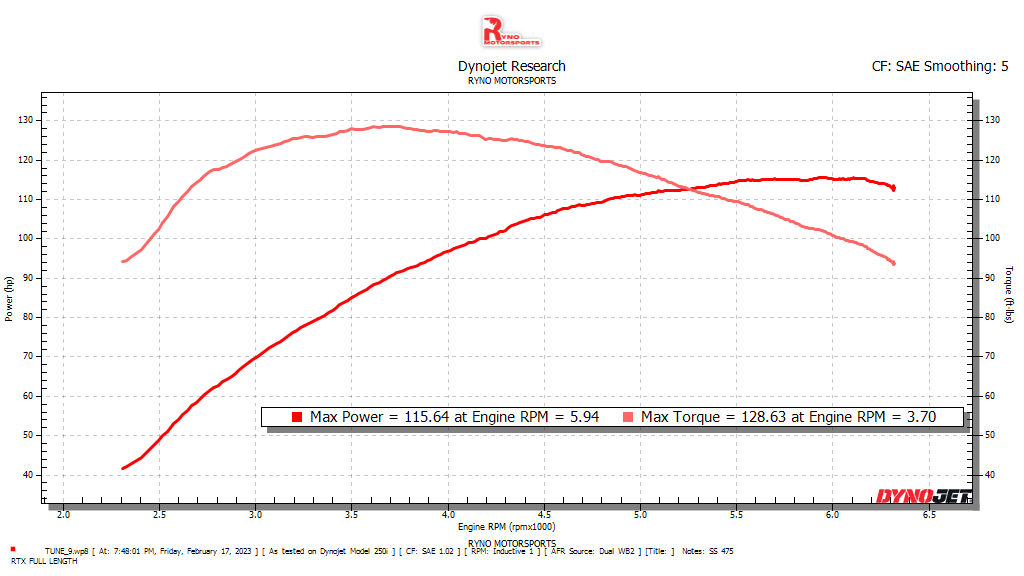

'22 114 FM RTX 2-1 full length Custom filter S&S 475 stock manifold stock injectors. Clutch springs.
You should post it in the M8 dyno sheets sticky. https://www.hdforums.com/forum/milwa...o-numbers.html
