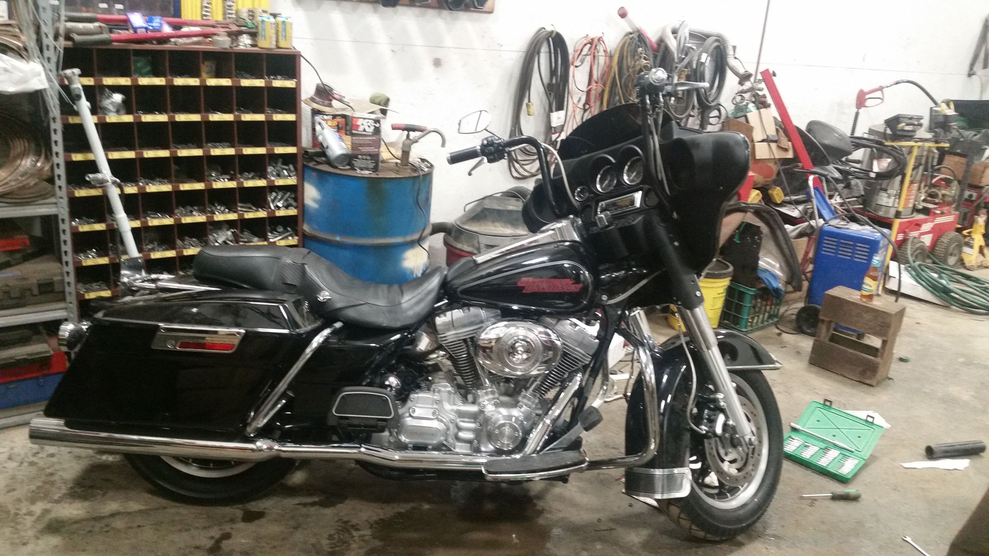

2006 FLHTi w/ 14" Hill Country Customs classic apes. Kit came with all cables cut to length. Worth the $ and effort to replace the cables for sure.

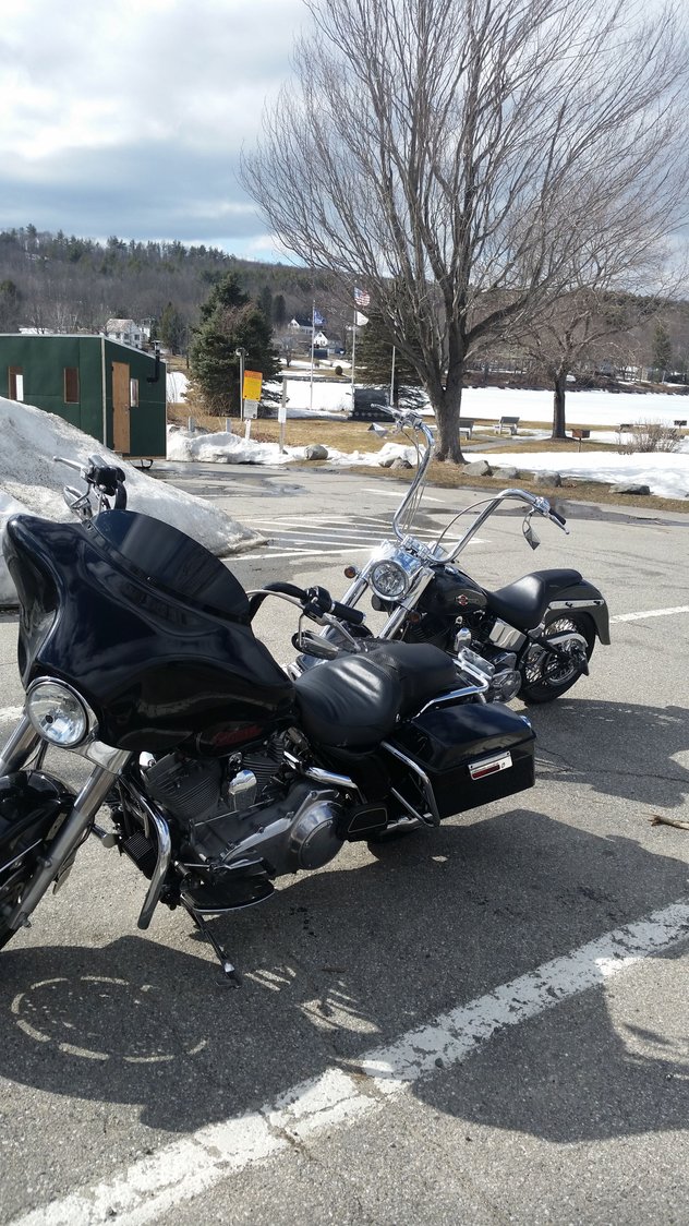

Hcc 14"bagger apes im 6 '1 n i wish ida gone 16s if not 18s
Lake in background had 30inches of ice still n snowbanks wers plenty big still but we had to ride this day lol
