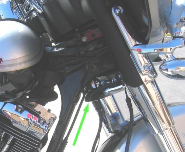

Here 'tis...again...

I've got one in black. It's standard equipment on the Road Glide.
$14.61
part number: 58520-79A
FYI:
The 79 means they've had it around since 1979.

Going to install mine today!! I sure hope it helps…Unless you have ever experienced Buffeting, you have no idea how frustrating it can be. Those of us with it will try just about any cure to fix the problem. Windshields are difficult to recommend as a cure, we are all different heights, have different seat set ups, and have different riding postures. With that said 1 common theme is taller shields are better, other common fixes are, as mentioned the between the forks baffle, and the other common item fix are the fairing mounted air defectors, I have these on order as well. Here is the HD link

I have the fork baffle and a 8" recurve and have no issues.

Worked wonders for me regardless of windshield.
Chrome Front Fork Air Baffle
Deflect the cold night wind rushing between the fork tubes of your Touring model. This stylish chrome air baffle replaces the Original Equipment black baffle on '00-earlier models. Includes chrome mounting hardware.
58520-79TC
Fits '80-later FLT, FLHT, FLHX and FLHR models (except FLHTCUTG).
MSRP US $24.95
