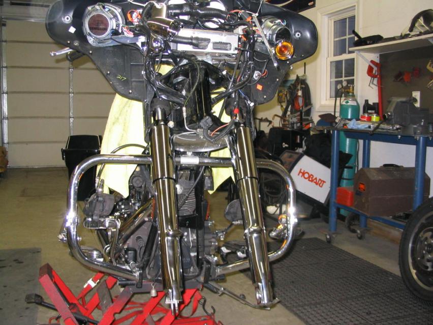

I read one post where the installer didn't remove the forks from the trees when installing chrome lowers. He split the PVC coupler/pipe so it could be slipped around the fork. I'm assuming he used repeated upward force to seat the seal. Does anyone have any experience in the above install and is it doable??? If it works, it's less work that for sure!!!

Thats correct, no need to remove the leg. the seal is relatively easy to tap down and into the leg. I used some ABS-black plastic drain pipe, forgot what size, maybe 1 1/2"or 2", cut in half and a rubber mallet.

I don't pull the leg outta the tree. I simply push the seal in place using a couple of wooden dowels or similar. I put them 180 degrees from each other and push the seal home.

I leave the tubes in the trees until I pull off the lower legs, then I loosen the tubes and remove them from the trees. It is way easer to work putting in the new seals and filling the tubes back up with new oil. After loosening my tubes with the pitch bolt, my tubes slide out easy. I also use a PVC tube spit in half to seat the new seals, real easy see pic.
