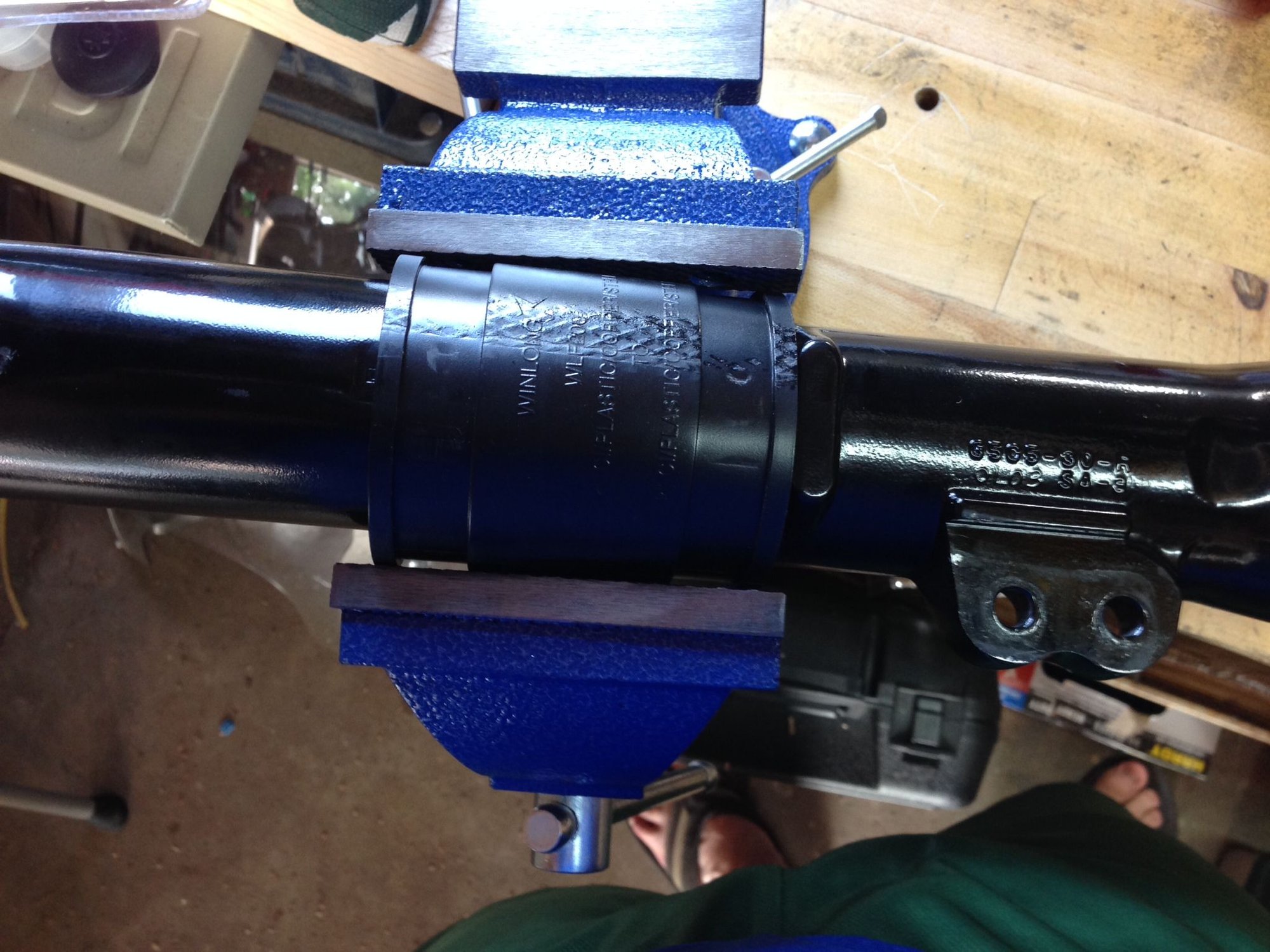

Here's a $3 solution I used. a 2 inch PVC boot slid right over the lowers on my forks, and I just grabbed it with the vice just tight enough to hold it. 1 1/2 might fit over the down tubes, but i dunno.
