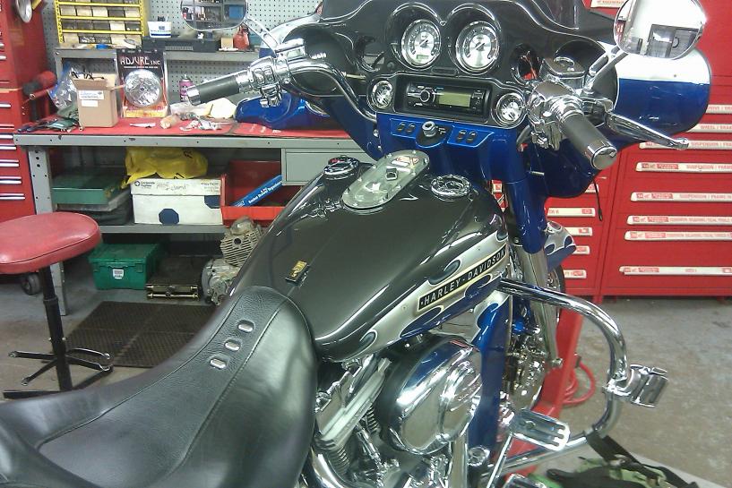

So a few more photos after today- still have quite a bit more to do-
Attached Thumbnails Non MOCO CVO!!-imag0152.jpg   Non MOCO CVO!!-imag0153.jpg   Non MOCO CVO!!-imag0154.jpg   Non MOCO CVO!!-imag0155.jpg

lets see a picture of the back wheel...paint flows nicely

Looks a lot better than it did.

I don't know about the paint. Maybe it'll grow on me. You're doing a nice job.

Ok, how did you get those gauges to work on an '03??? I love my '03's but I wouldn't have taken apart an '03SE. But it is your bike and I'm with you on wanting to make something "different" on your own!!

Well done and I think a complement to a CVO.

Originally Posted by 68NIOU1
And the final ones for now- still waiting for sheetmetal which will probably be another month. Also, for anyone out there looking to do an Agitator wheel on a older frame, just in case you missed my other posts, here is what you need-
Agitator wheel
Bearing kit
Agitator rotors
Updated 08 and later Brembos or equivalent brakes
08 and later front axle and spacers
As you can see, it adds up quickly. If I was to do it all over again, I would probably go PM as I could match the rear wheel a lot easier, but I do like the look of the front end.
So are you sayin its more trouble/cost than its worth? I was wantin to do this to my 05 EG. Stealer tells me its not possible, posters on here have told me its no problem. Glad to finally find someone who has ACTUALLY done it!
