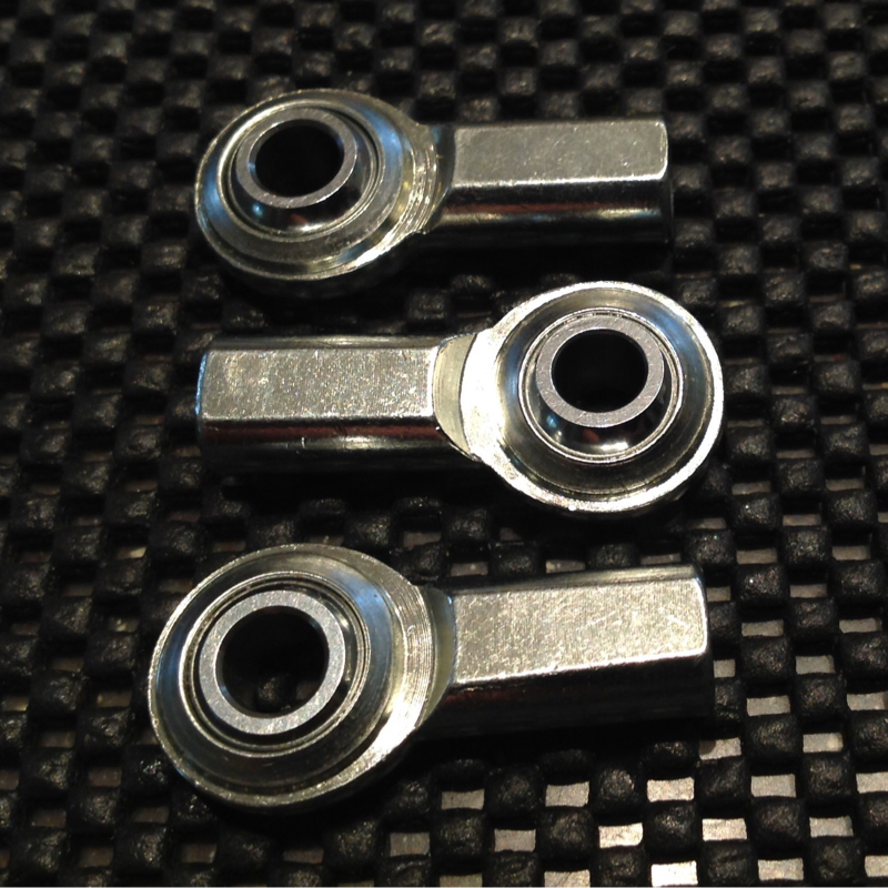

Originally Posted by GriffinDenim13FLHX
Mine are completed and was an easy mod to do. Much firmer shift (feels like). As well a piece of mind that the linkage will not fall off in the middle of nowhere. Which in Idaho , middle of nowhere is easy to do here. Took about 10 minutes to do. Did not have to do any adjusting, or moving the teeth on the splines. Perfect size HEIM joints worked great. Purchased my set through: http://www.ebay.com/itm/391165355207...%3AMEBIDX%3AIT Trusted seller, 100% feedback, nice product.
I see this kit comes with two 1 1/4" bolts, but the OP used one 3/4" and one 1". What have other folks used.
Thinking on finding some Allen head or button head bolts this weekend in preparation for the ends here next week.
http://pages.ebay.com/link/?nav=item...obalID=EBAY-US
And not bad looking pieces either. Got here very fast.
I used 1" on both ends, works. But I'll be revising it eventually for a more unique look.
Probably naval brass.
