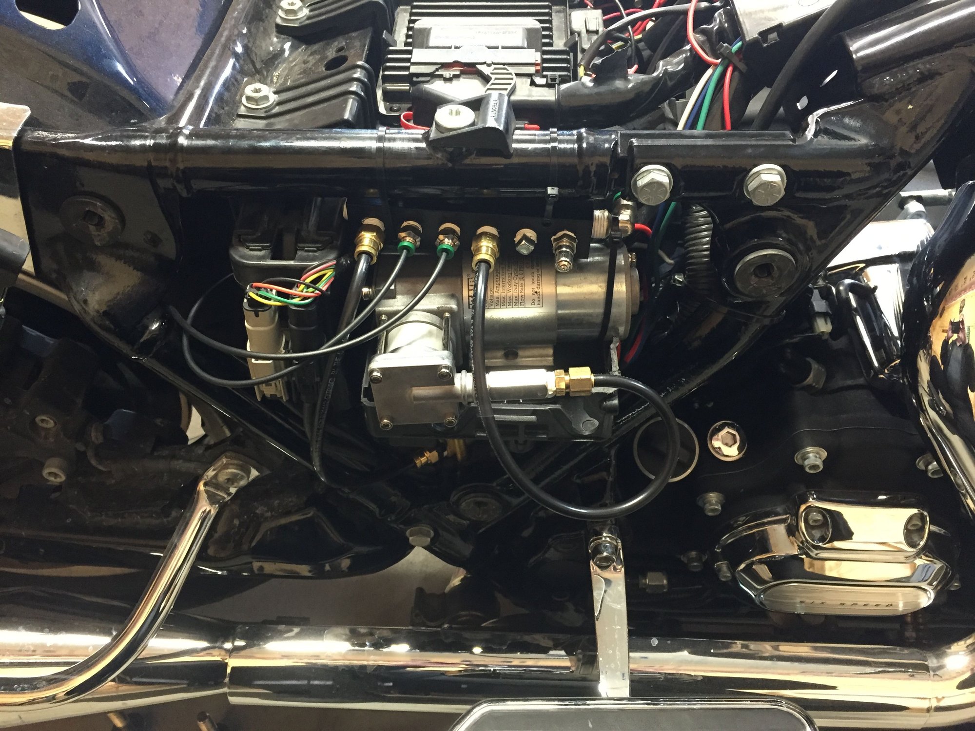

I installed my compressor next to the battery where the ABS would be.
It works great!
It works great!
Looks like you did a great job with that set up. Makin a manifold for the airlines like you did. Looks like less possible chances for an air leak.

Did you build that air manifold, or buy it? If bought where, it looks great.
I bought a manifold like that:
Amazon.com: VIAIR 6 Port Billet Manifold with Mounting Holes (1/4" NPT): Automotive Amazon.com: VIAIR 6 Port Billet Manifold with Mounting Holes (1/4" NPT): Automotive
but it takes up to much space, needs all the plugs, connectors, and creates potential leaks.
I went with this instead:
MettleAir MTKG 1/4-1/4-1PK Push to Connect Inline Manifold Union Fitting, 1/4" OD: Push To Connect Tube Fittings: Amazon.com: Home Improvement MettleAir MTKG 1/4-1/4-1PK Push to Connect Inline Manifold Union Fitting, 1/4" OD: Push To Connect Tube Fittings: Amazon.com: Home Improvement
Works fine, after 5k mls no issue...
Thank you

I may end up switchin to the manifold set up like that. My system has a slow leak it in. Slow enough that soap and water cant seem to find it. Not that its a big deal it just kind of annoys me.

I got it from Jerry Brickle Racing.
http://www.jerrybickel.com/push-lock...nifolds-1.html
It's nice and compact.
Just use Airedup to get the fittings you need.
I added the schraeder valve in my manifold incase the pump dies.
Makes it easy to check for leaks.
I ran a loop to bypass the shocks to test all the fittings.
It showed me that my slow leak was in the shock itself.
