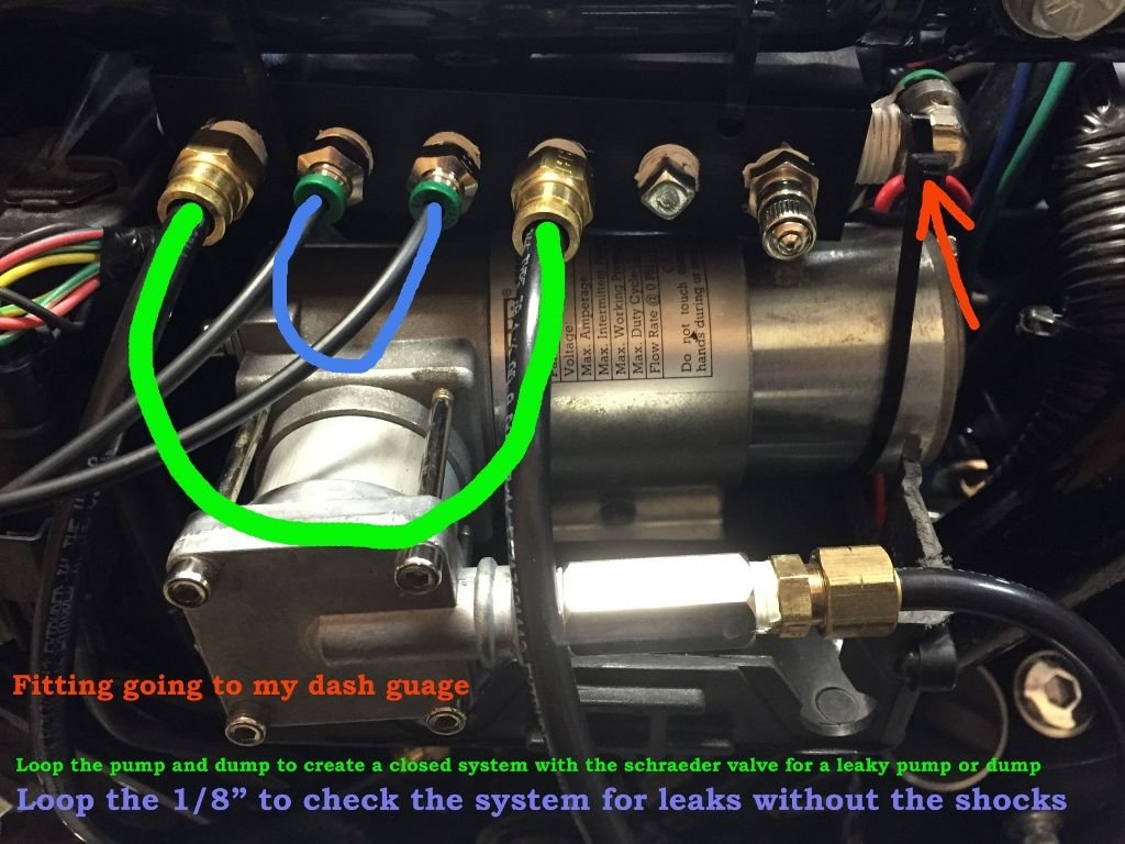

I may end up switchin to the manifold set up like that. My system has a slow leak it in. Slow enough that soap and water cant seem to find it. Not that its a big deal it just kind of annoys me.
Here's what I did to test mine:

Thats a good idea. I didnt even think to do somethin like that. I dont have a manifold set up but i can loop my lines after my 2 reducer fittings. So since you had a small leak in the shocks themselves did you just deal with it or replace the shocks? Im kinda thinkin the warmer weather is whats effecting mine cause i didnt have any issues over the winter.

i developed a couple small leaks over the winter, so I blame mine on the cold weather. I changed all my fittings to DOT fittings and no more leaks.

I welded my eyes to strengthen them so returning them wasn't an option.
I had to order new ones.
Now I have a spare since only 1 leaked under the mounting eye.
If you suspect your shocks, remove them from the bike and put them in a bucket of water with 120lbs of pressure in them. Watch from the dreaded bubbles.

1coolZ71, I appreciate the clear photos. It's a nice set-up. The schraeder valve is a good idea!
