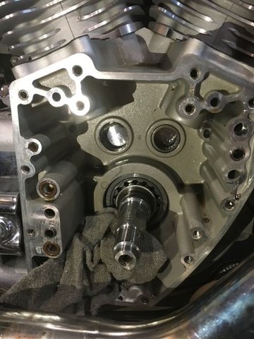

Default 2003 Screamin Eagle 103 - Bearing failure at 58,000 miles
Yes. I am a sad recipient of a virtually complete engine failure due to cam needle bearing failure after meticulous care of my 2003 Screamin Eagle Road King.
I will always wonder if this was an original design failure or "...just a fluke failure" as I was told by the Harley Dealership???? Anyone want to 'weigh in-I'd love to hear what you think.
See pics attached.

Originally Posted by pnwlimited
For what its worth...I installed my Woods 777's today and when I was installing the new cams I almost thought of leaving the existing bearings in. I looked at the old cams surface and seen where there was some wear on 1 of the cams, and that was enough for me to go rent the tool and replace them with the torrington bearings that were in the kit I bought from Fuel Moto.
My sentiments exactly.To me HD designs their bikes for low mileage riders. I went to stage 2 on my '06 Nightrain and found (not a planned discovery) that the hard surface on the inner cam journal was wearing off at <33k. I had planned on torrington bearings just to be safe and as it turns out in my opinion they were absolutely necessary. My original motivation was to get rid of the STUPID spring loaded cam chain followers. Once you did that there was no reason to not change the cams. Also bought a ECM piggyback. Not a cheap investment but I was more than happy with the results and traded the bike in at 92k. Now I wish I hadn't... Or I should have kept it and my RK. Harley doesn't make a do all motorcycle....

From: San Diego, CA
Don't forget, the 88" engines took the B-148 inner cam bearings and the 96"+ engines went to the B-168....
It's possible the 96"+ engines didn't have the failures of the 88" engines because it's a bigger bearing.... who knows..
While I won't take a Twin Cam engine apart just to replace the OEM INA brand cage bearings, with the Koyo-Torrington captive needle bearings, the Koyo-Torrington is a superior bearing...
If I should go into the cam chest for any reason, I do switch to the Koyo-Torrington bearings... and on an 88" engine, I will be in the cam chest to upgrade the spring cam tensioners at some point...
