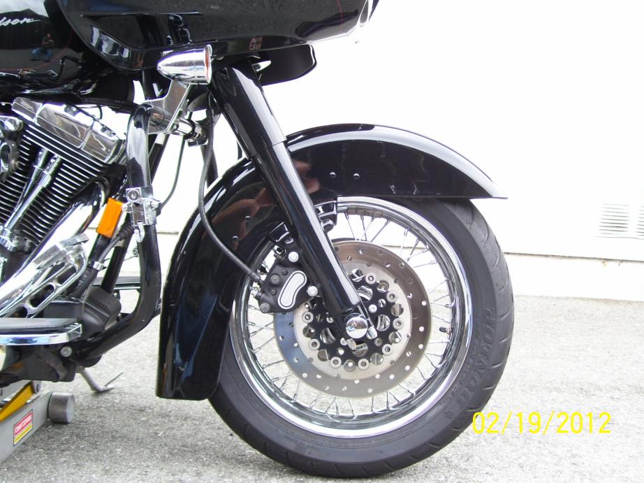

Been keeping tabs on your build. Great Job! I have to get to get my a** out to my garage. Since your going with the Profile Spokes have you thought of going larger? I have a 17" on mine. It lightens the front end look.I would like to get a 18" from a 2011-2012, but the one's I have seen are to much $. Keep up the good work
I'd love to find an 18" Profile, it would help fill in the lowered front fender. I keep watching craigslist and eBay. I've got time to wait, could be part of next winters upgrades....
