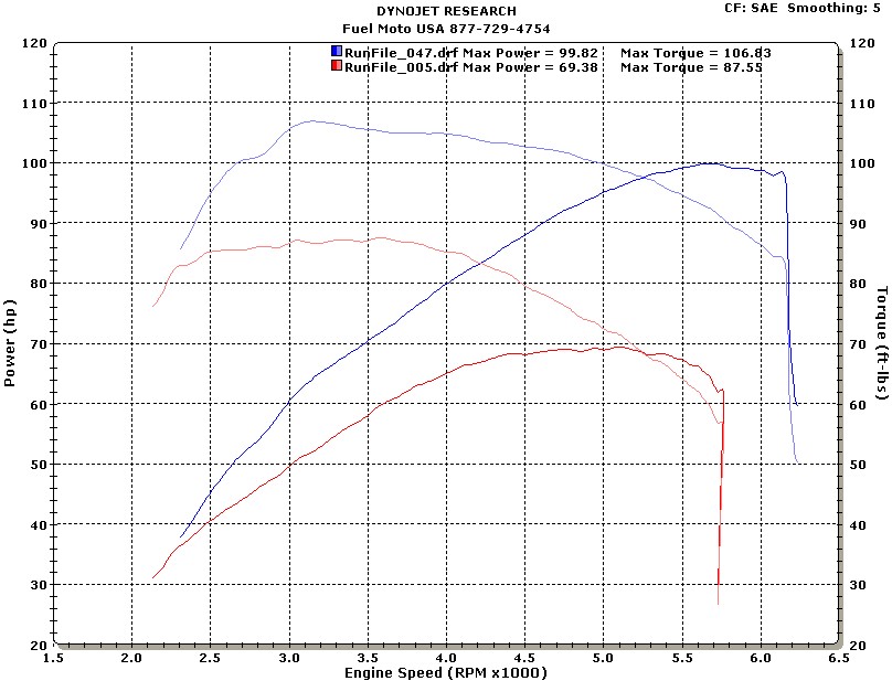

What's the torque @ 2500 with stock cams?
Most of my ride is 2300 to 3000 and no need to "blip" to let the clutch out.
Al
Old Jan 27, 2012 | 11:49 AM
TNCarters's Avatar
TNCarters
Joined: May 2009
Posts: 867
Likes: 17
From: Brentwood, TN
Fuelmoto plots shows stock to be about 85 ft-lbs at 2500 rpm on their dyno. Here's link to a comparision of their 103" stock vs. a stage 2 with an earlier Woods cam.
http://www.fuelmotousa.com/limitedstkvswoodtw6.jpg
